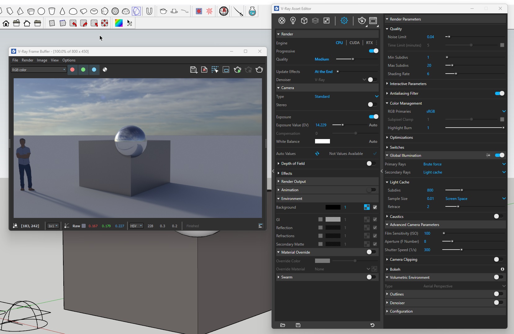

    Hello! I've searched everywhere but still haven't found an answers to my problem so I hope someone here will have an idea of what I could do. My scene is rendering with a blue tint on metal and glass reflections. Any thoughts?
    You can turn on real-time rendering, turn off all the lights in the light list, and turn them on one by one to see which ones are affected
      It's the Sun Light. I changed to a Dome to try and fix it but I still get the blue tint.

                In order to find the source of the issue it would be best if you could send the scene to our support team to take a look. We can guarantee that any information you share is used for troubleshooting only and if needed we can provide you with NDA agreement. If it is alright with you please open a ticket using this submit request form and upload the archived scene in the ticket (make sure to use Pack Project tool (Extensions>V-Ray>Pack Project tool) in order to archive all textures). You can delete all sensitive information from the scene like geometry, but make sure that the issue is still reproducible.
                Also please share your exact V-Ray version (Extensions>V-Ray>Help>About V-Ray).
                If you are still unable to share the scene any additional screenshots of your settings will be very helpful.
                Especially please share your current Environment Background texture and Dome Light settings or Sun Light settings. Also please make a screenshot of the overall setting (Camera, Environment tab, Color Management etc.) Apart from that share if you have any post-production Layers in the VFB, test if disabling any of them helps.
                As a possible workaround you can try to enable global Environment overrides (please see documentation), similarly it can be done on a per material basis (please see here).​​

                  I think you may have turned on environmental fog and gave it a blue effect,&check sun color。try turnoff。or reset all rander setting.Focus on checking the sun。

                    Many thanks everyone for all your help, I did a light gen to get a new dome for my file and, as natalia.gruzdova pointed out, I had a post-production layer on that wasn't helping either.
