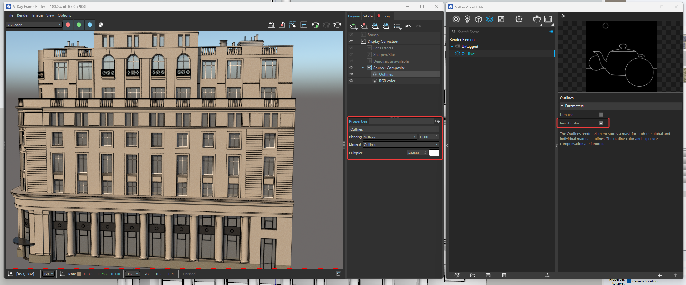

    If you need black Outlines:
    • Add Outlines Render Element and enable Invert ;
    • Enable Outlines in settings > enable Rendel Element Only;
    • In Composite ass Outlines on top of RGB color render element;
    • Change Outlines Blending to Multiply and set Multiplier to 50.

      Hi Natalia,
      Thanks for the heads up.
      I have followed your instructions for creating a black outlines overlay, but the resulting Outlines render elements created a very bright image, instead of the expected black lines on white background.
      As result, the compositing procedure you recommended results in washed out outlines, instead of black ones.​

        Antioche, would it be possible to share your scene so I could take a look?
        If this is alright, please open a ticket using this submit request form and upload the archived scene in the ticket. Make sure to archive it with the Pack Project tool (Extensions>V-Ray>Pack Project tool).​

            Thanks to Antioche we have identified an issue with Outlines Render Element. Currently it is being affected by Exposure values, moreover results with Progressive and Bucket image samplers differ.
            The issue is logged in our internal system as SK-4658, both this forum thread and your ticket is linked to it. Thank you for your report!
