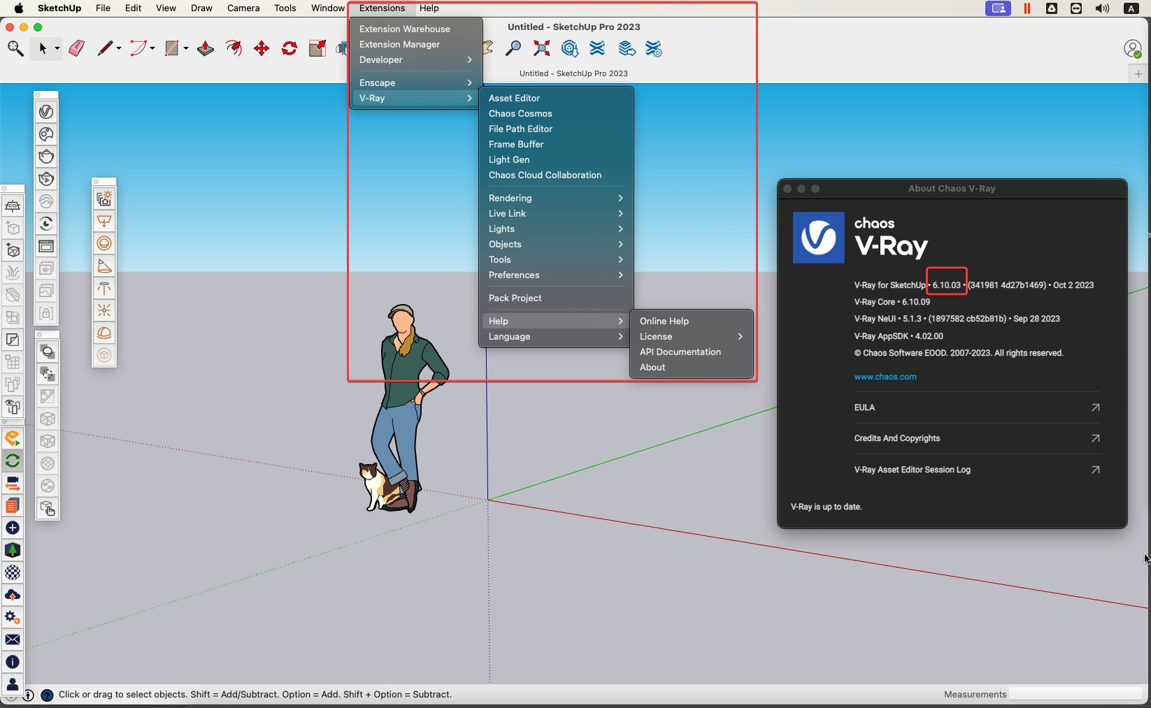

    Can you please let us know what V-Ray version you are using at the moment? Please share a screenshot of About window V-Ray for SketchUp.

          Share your V-Ray version which can be checked in Extensions>V-Ray>Help>About tab.
