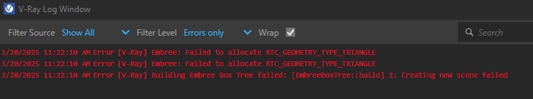

    When I’m trying to render a scene there’s always an error and it fails. I have tried with other files and also with a new project and every time the same error appears, the errors started when vray was updated and in other pcs it worked correctly. I've seen in other forums that the error might occur because of RAM, but in this case the other pc had less ram than the one I'm trying to render.
    Error [V-Ray] Embree: Failed to allocate RTC_GEOMETRY_TYPE_TRIANGLE
    Error [V-Ray] Building Embree Box Tree failed: [EmbreeBoxTree::build] 2: Creating new scene failed
    Hello alejandro_pea,
    Thank you for reaching out to us.
    Please Reinstall Microsoft Visual Redistributable: https://learn.microsoft.com/en-us/cp...-2019-and-2022
    Download and install the X64 https://aka.ms/vs/17/release/vc_redist.x64.exe version.
    Once installed please restart your machine and try using V-Ray in a new scene and let us know if the error is still reproducible.​
