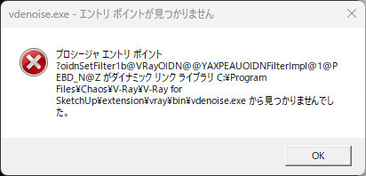

    vdenoise.exe does not start on V-Ray 7.00.03. (windows11)
    The following error occurs.​
    VRayRhino is the same

      Hi flat​,
      Excuse us for the delayed response.
      The issue you are describing is 100% reproducible and logged in our bug tracking system as SK-5372.
      We'll do our best to resolve it quickly.
