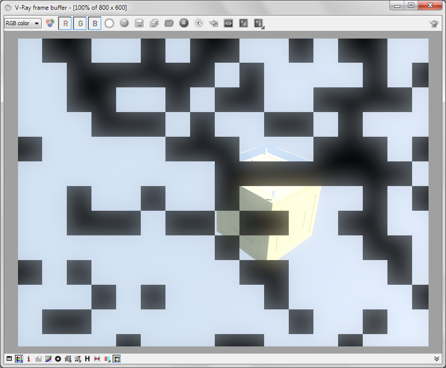

Black buckets when using postpro effects
  • Black buckets when using postpro effects
Name:	V-Ray frame buffer.jpg
    This is the result I get when using either type of postprocessing effects.
    First, always after turning on postprocessing effects, v-ray tells me to re-render because no channel is detected.
    Then, when I do, the effect is active, but shows black buckets. Randomly.
    First I thought this might be because of distributed rendering but it occurs both with dist. rendering on and off.
    Are you using any exr files in your renders?
    SU 2018 + VfSU 4.0
      Hmm odd.
      No, no exr.
      I'm trying to reproduce the error again, but although it happened to me a lot of times before, right now I cannot reproduce it. Maybe I lost track of v-ray versions...
        if you're using any of the camera effects like bloom, unfortunately those are not working with DR currently.
        I'd sent a bug report about that ages ago.
          Yes, this has been reported and it is on our to-do list.
