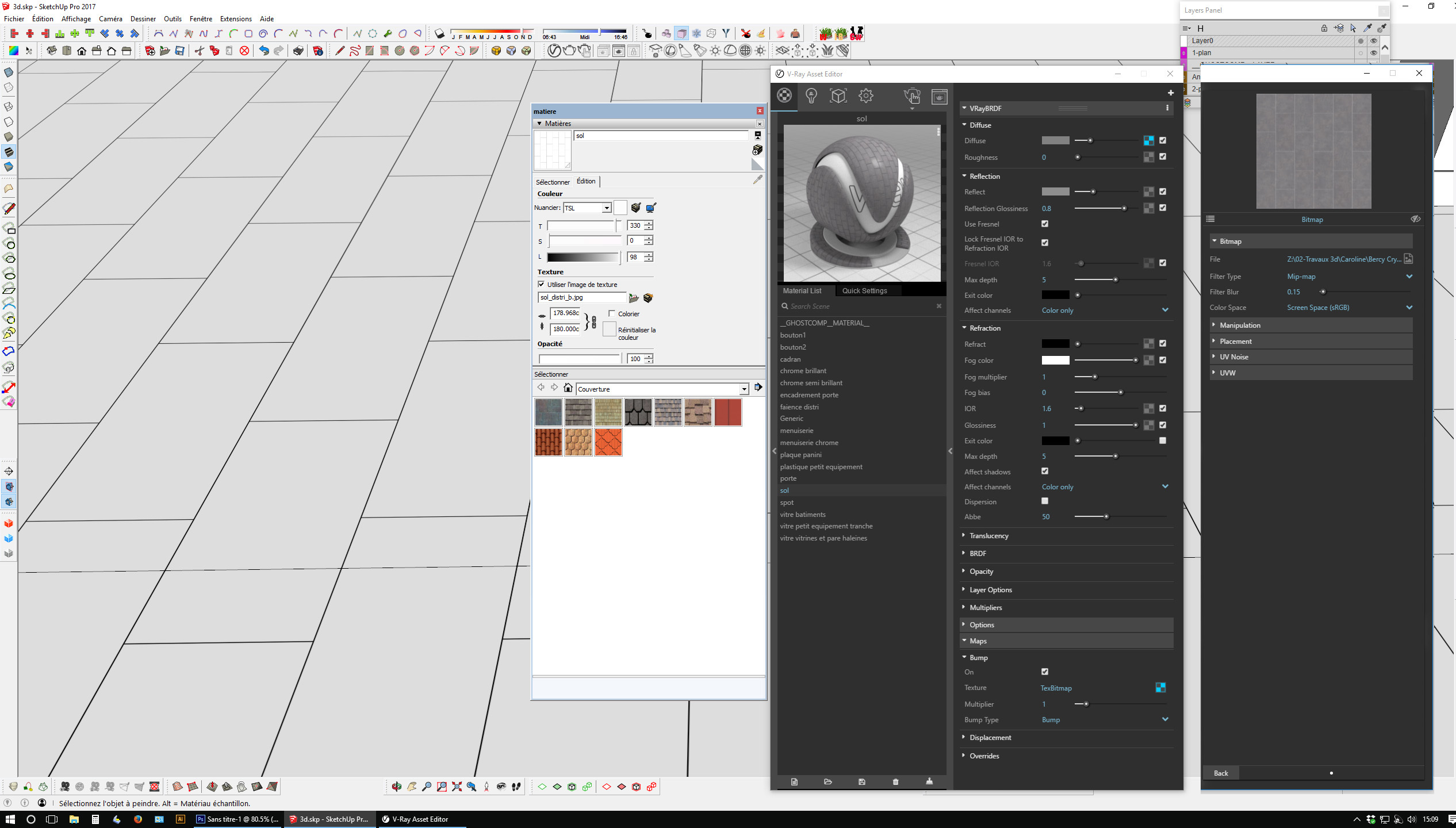

    Hello,
    I have dowload and install the last version on Vray 3.4 and i have problem with material.
    When i change bitmap inside asset editor, the texture inside sketchup material doesn't change.And it does the same thing in the other direction.
    I haden't this problem with the latest version, 3.3.
    See attachment file.
    thanks
    V-Ray for SketchUp 3.4
    Windows 10 pro 64-bit.
    french
    SketchUp 17 french, artisan,fredo scale....
    intel i7 4790k
    geforce GTX 980
    Ram:32 g

      OK thx , but if i change bitmap in sketchup material, there is no change in asset editor.
      Am the only one to have this problem?
          This is a known issue indeed.
          As a workaround, be informed that the material preview in the Asset Editor will display the new texture if it is refreshed. For example, change the preview scene (using the three dots button at the top-right corner of the preview window) to something else or switch between materials using different swatch scenes.
