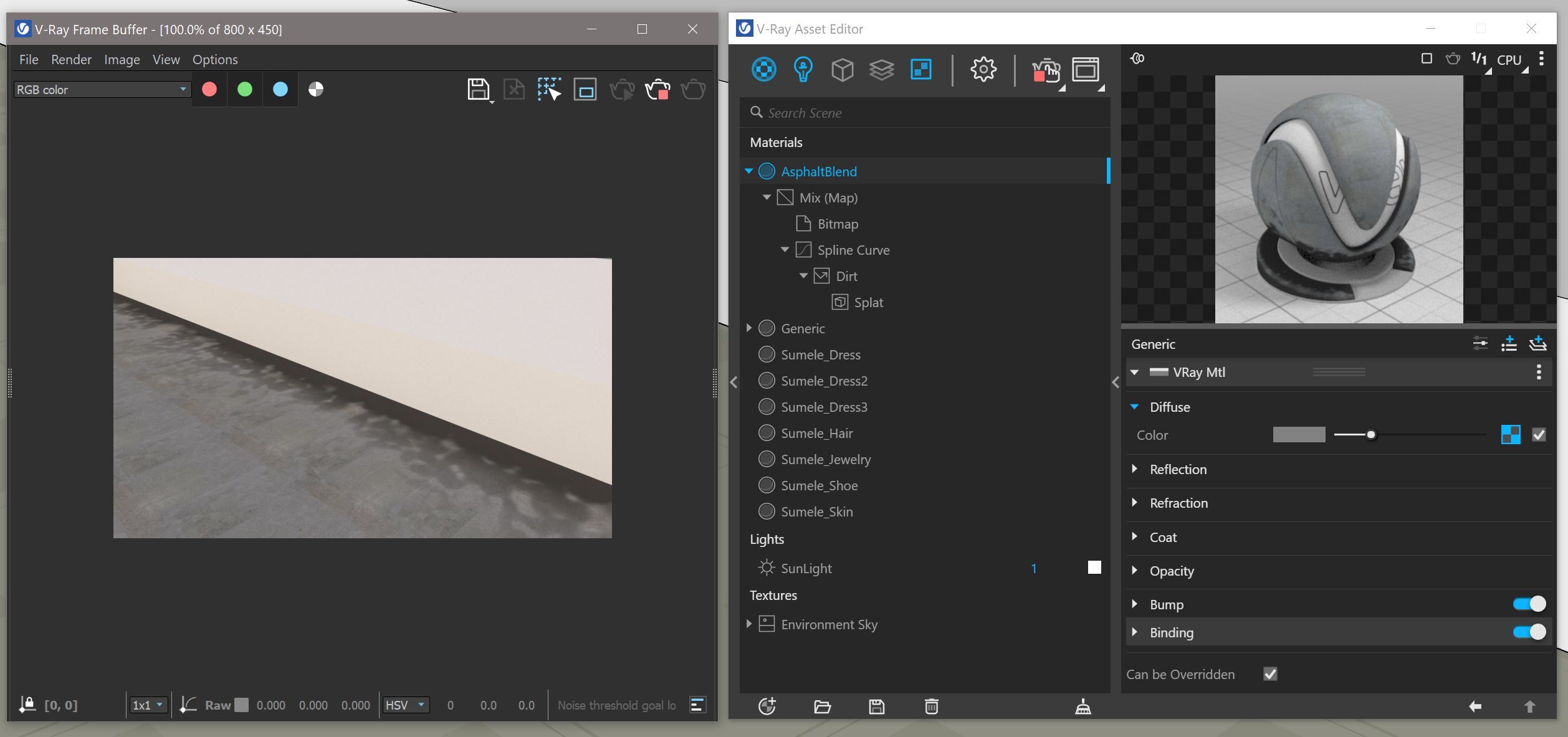

        Hi guys,
        Another option for blending shader effects based on an occlusion from nearby objects is using V-Ray Dirt texture.
        By default it'll give you a quite smooth faloff gradient but if you pass it through a Spline or Bezier Curve correction you can make the effect more pronounced:
        Click image for larger version  Name:	Asphalt01.JPG Views:	0 Size:	168.6 KB ID:	1104188
        Here I've used the following setup:
        • Mix Map in the material's Diffuse slot
        • The Asphalt texture in the Mix top color
        • The 'weathered' texture/color in the bottom slot
        • Spline Curve correction in the Mix Map slot
        • Dirt map in the Spline Input slot
        • The Radius of the Dirt map was increased and a Value remap was used in the Spline map
        • The Dirt Map Radius parameter was also textured with a noise for variation
        The main limitation of this approach is that objects can't be excluded from the effect.
        And if you place any other object on the road - the same weathering will surround it.
