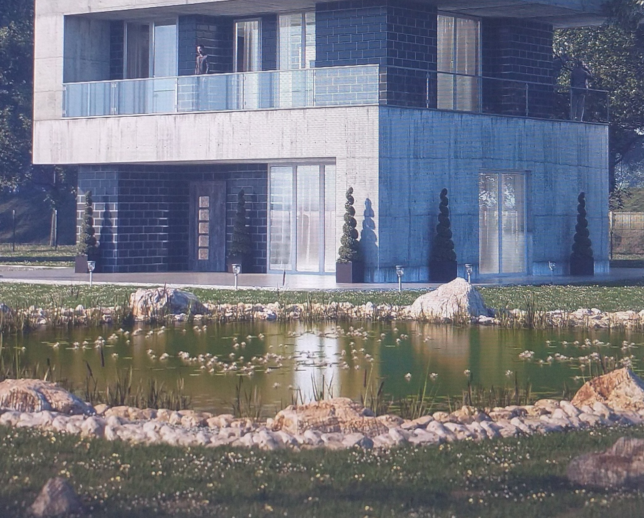

    Hi Konstantin, Peter Chauchev and Muhhamed
    I'm rendering some spaces and there is another tool that i don't use but i should use since this happens in real life and gives the renders another level of Quality and realism and that is depth of field.
    3 things
    First is slower to render a scene with depth of field like 20 or 25% that with out it.
    ​​​​​​Second is that in order to achieve a better bokeh effect i have to increase a Lot the subdivids in the Quality slider, to get a clean bokeh effect.
    Third is that how can i know how much defocus is needed to get a Nice shot with depth of field?
    Sometimes i have to guess in order to find the Best defocus, and i have to do some test to find the Best number and i Lost time just triying and triying yo achieve the Best defocus number to get a Nice shot.
    The option of Focus distance is great but i would like to enhance that part so vray can give us the Best number for the defocus.
    Depth of field is very important for architectural rendering.
    Click image for larger version  Name:	IMG_20220623_011949130_MP~4.jpg Views:	0 Size:	340.2 KB ID:	1151985 i loose a Lot of time just guessing what kind of value is the Best... Not to much depth of field but at the same time a Nice effect of that.
    That could be really a Nice feature or a Nice upgrade in the camara roll for vray gpu 6 and vray 6.
    Thanks
    Best regards Luis Gamino

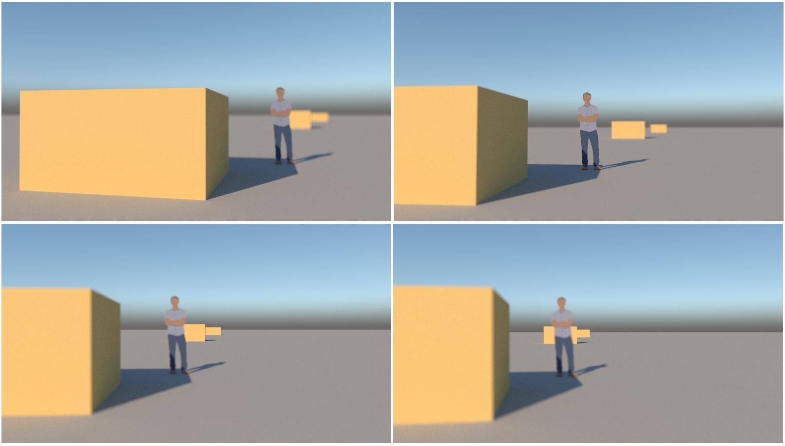

        There are three modes of setting focus points in V-Ray for SketchUp:
        • Static focus distance from camera (this is the default option) which can be manually typed in or calculated based on a selected point through the "Pick point" button.
        • Camera target - the focus distance will dynamically change based on the object currently positioned at the very center of your frame.
        • Fixed point - after picking a point on any object the focus distance will change dynamically based on the distance between the current camera location and that point.
        Here's an example of focus distance based on camera target:

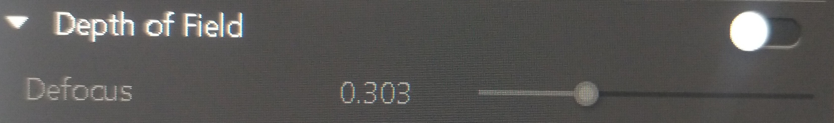

          Hi Peter
          I think Muhhamed suggested a great idea, if we can pick at the interactive render which part of the image You want to Focus in the frame buffer that could be really Nice
          Thanks for help and the hints to use vray depth of field with camara settings i already khow that since some years ago i took some lessons in order to understand how we can use depth of field.
          My Main point here it needs to be more práctical.
          ​​​​​​also how can i know which is the Best value for defocus
          .30
          .33
          .27
          .35
          .4
          .303 is the default, but how can i know if .31 is too low and .375 is too high
          How this tool works with 3d max and maya. Muhhamed told me in vray for 3d max and maya, there is an option that with a single click You choose at interactive render which is the Best option and gives You a fast feedback how is going to look the render since with a single click You choose what is in Focus and what is not focused.
          Also i understand about the Focus distance, camara Target and dices distance
          But no single option gives You the defocus value... Sometimes i have to do some experiments in order to see the Best value
          I hope i can express My self with clarity
          Thanks again
