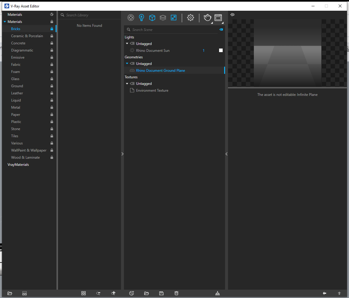

Hi,
So I want to import the Standard vray materials library back in the asset editor. But after reinstalling vray 6 and such I lost the old vray 5 user folders. Bad times
I did find a material library in the program files directory but when I try to link that the vray asset editor displays a fancy blue lock symbol which probably means just "no"
Where can I get a backup of the vray 5 material library which I then can reference into the asset editor? Anyone?
I do not want to have to keep downloading and importing even the simplest of materials from the cosmos browser, I just want my materials in the asset editor.
I use materials from a wide array of sources and being able to acces these from the asset editor is key for texturing speed.
Thanks
**So I did figure out a workaround which is manually downloading the assets from the cosmos browser and manually saving each material as a vrmat file in a folder, If someone could spare me the time and share a download link to the same end result I would be very grateful**Last edited by robbie_bruins; 17-03-2023, 05:01 AM.
Hello robbie_bruins,
As Peter shared in his post, should you have installed V-Ray 5 the old Material Library can be loaded manually from specified default locations.
Please note that Cosmos Browser has a number of other materials that are not included in the old V-Ray 5 Material Library and more will be added in the future.
Regarding why the library was moved please take a look at Konstantin's post and I wanted to add that having assets and materials all in one place brings a more universal approach to many users that work with V-Ray in several host-applications, as this way all the materials are created uniformly and rendering results are consistent in every application.
