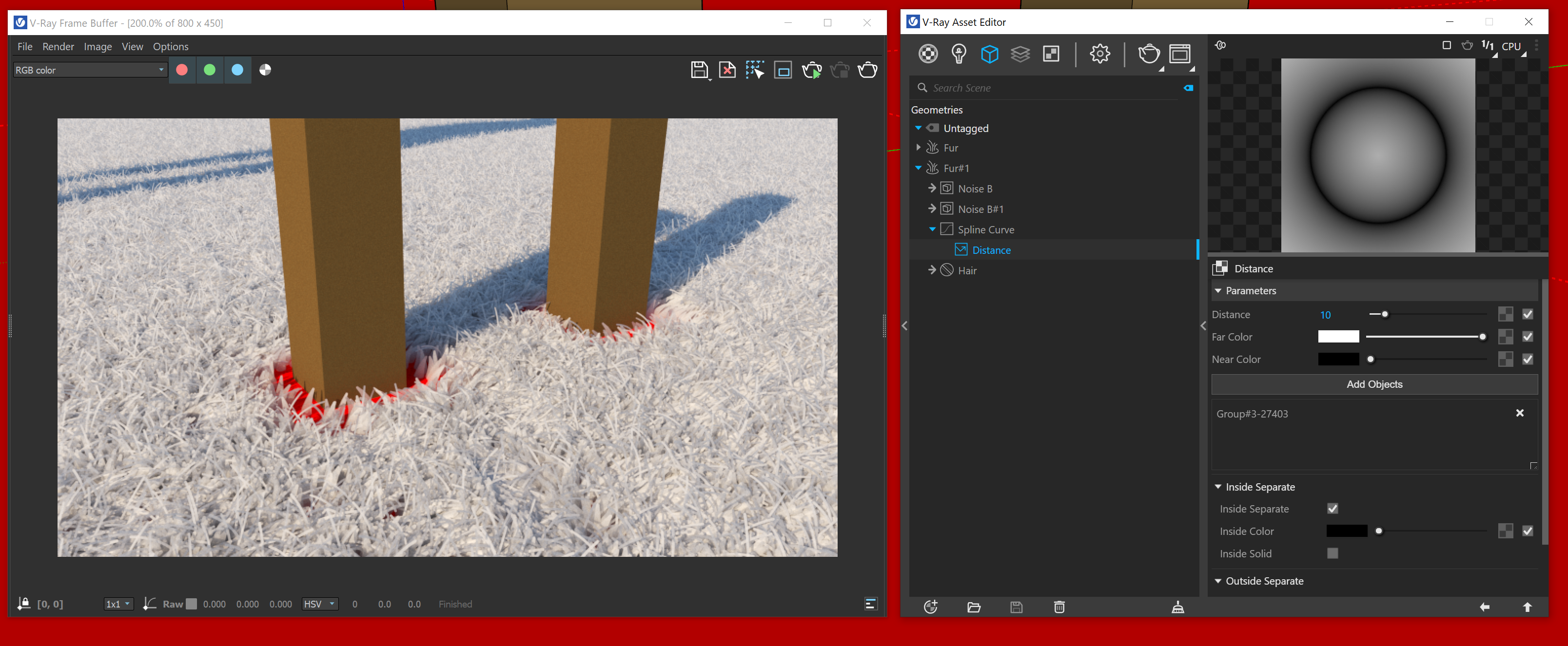

          Hi,
          The Distance texture can be used in this case, yes.
          Here's a simple example:
          In this case I've used a curve remap to change the Distance map's falloff and.
          The distance is then connected to the Density parameter of the fur.
          Konstantin
