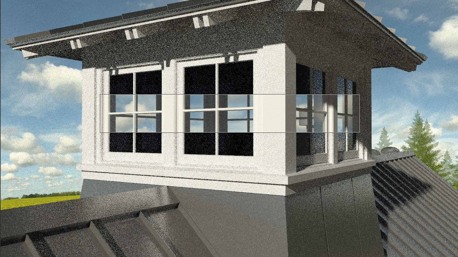

    I'm new to Vray and I'm attempting to figure out glass reflections for exterior window glass. Vray 6 and Sketchup Pro 2022.
    I'm trying to determine how to ghost the site reflection onto this model's window surfaces so that the interior can show too. The completely obscuring reflection that I'm getting currently starts at a more obtuse reflection angle, so one window sash is see-through and next one further away is not. Both of the windows to the left have the same glass - they are both the same components.
    I can see that people are creating graduated reflections determined by reflection angles, and on tutorials such as Justin Geis's YouTube videos seem to make adjusting the amount of reflection simply a matter of changing the Reflection Color and it looks pretty simple, but I have tried all of the settings he uses to adjust reflections and none seem to have an effect on the sky reflection.
    Does anyone know of a more basic tutorial out there? I've watched a bunch of videos over the last month, and I know I've seen glass reflections covered elsewhere, but I've failed to understand reflections and window transparency - I just need a step-by-step in-depth coverage tutorial.
    Coppola Sketchup Model Link
Name:	Coppola Settings.jpg

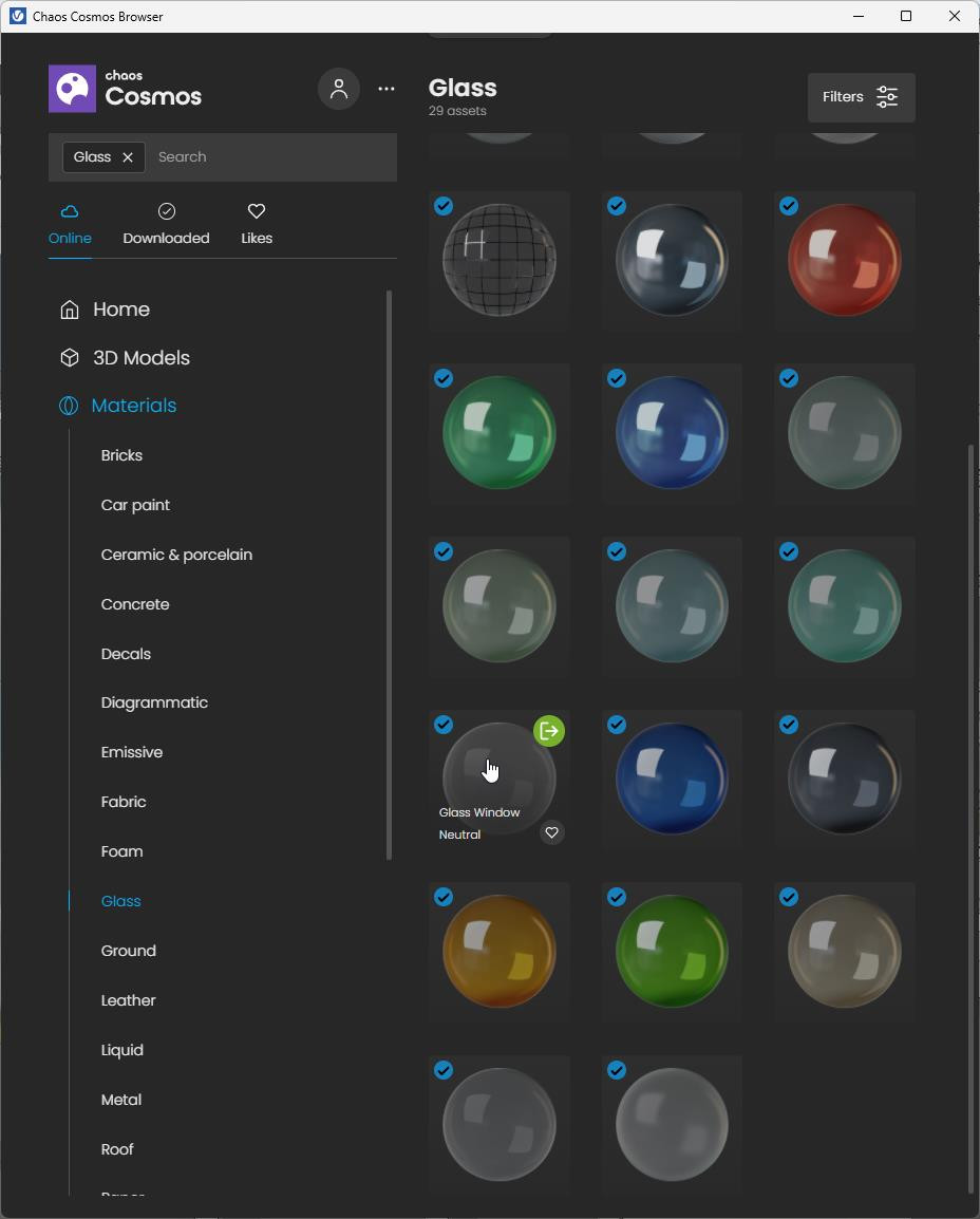

    I encourage you to check available Glass materials in the Cosmos Browser to see how they are created and change them to get the result you need. For example Glass Window Neutral also works well in your case.
    Click image for larger version  Name:	Cosmos.jpg Views:	5 Size:	111.7 KB ID:	1172402

      Click image for larger version  Name:	Coppola_WindowReplace.jpg Views:	0 Size:	750.5 KB ID:	1172970 Rendering with glass materials to match your settings is not transparent. The Region Render strip is with the glass material applied to the inside of the glass plane object.
      I happened to come across a forum posting on translucency problemes, and someone mentioned applying material to both sides of a glass material plane. Sure enough, after applying the materials to the inside of my glass object (it has thickness/closed geometry - not sure what that's called in Sketchup?), the material performed as it did with the model you uploaded. Did you also apply material to the insides of the glass?
