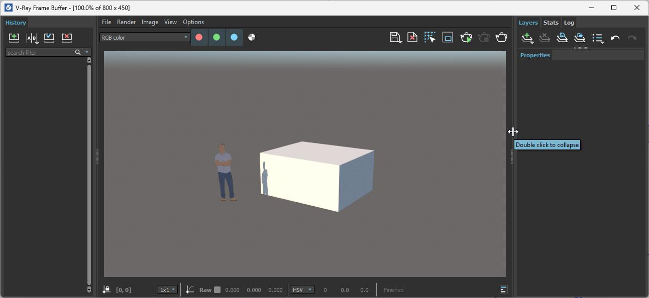

    I'm used to have the effect and curves panel in vray. After my license expired and then I sub'd again, the vfb doesn't shot the right side panel. I can't figure out how to bring it back?

    Double-click on the right side of the V-Ray Asset Editor to open Layers Tab.
    If you do not see any Layers perhaps you need to move the slider down. Please see the example.
    Similarly, double-click on the left side to open the Render History Tab.
