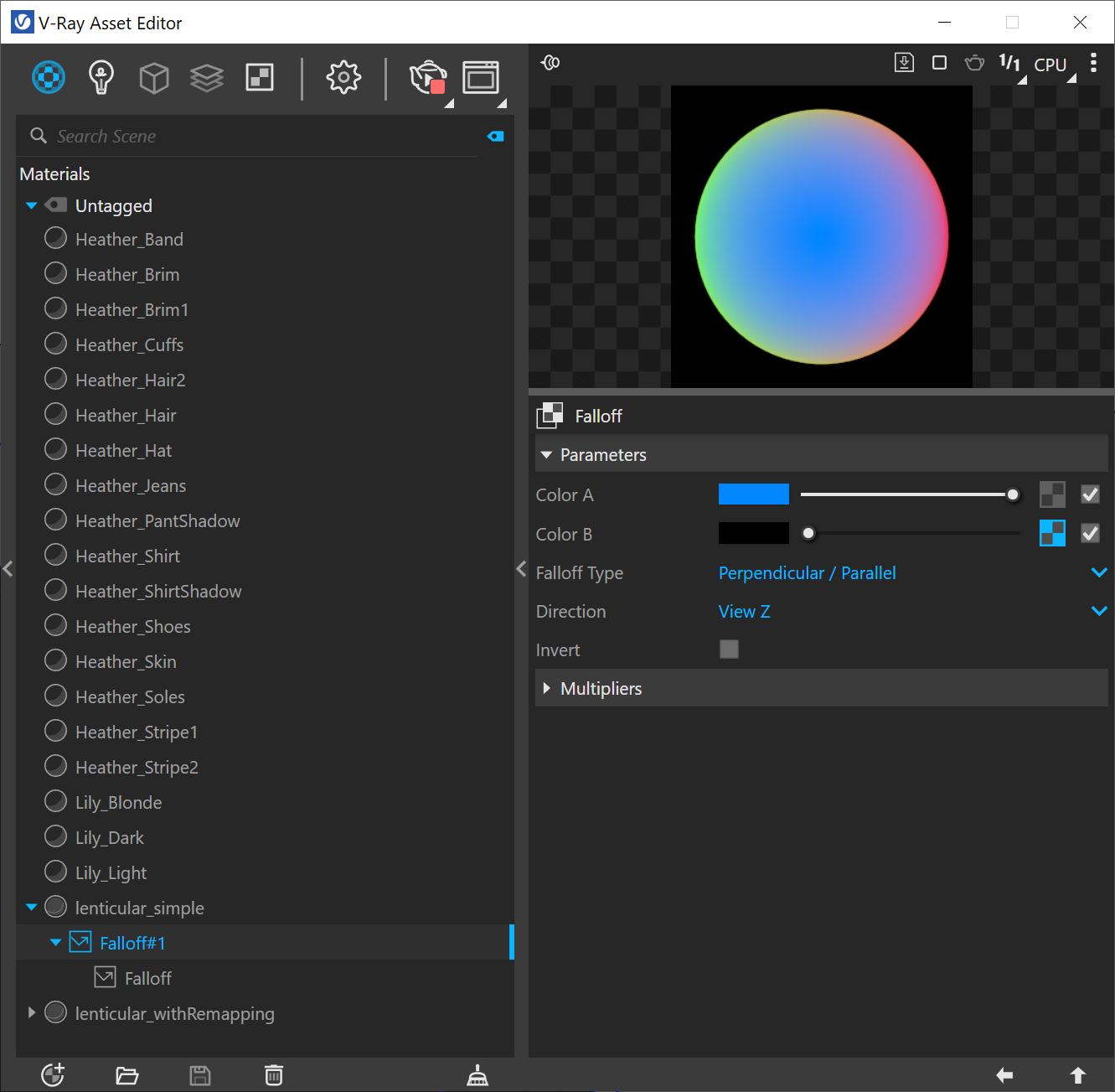

    The first falloff is connected to the material and has the following configuration:
    The blue Color A of falloff 1 is your middle color/texture - the one you see looking straight at the surface.
    A second foloff map is plugged in Color B.
    It is configured as follows:
    The green color/texture will appear on the left and the red one on the right.
    The only issue with this setup is that you can't control the falloffs - they are always linear.
    For finer control you can apply the same logic but use mix maps instead, where the falloff textures are used as a mix value.
    This way the result from each falloff can be remapped with a bezier or spline curve correction:
