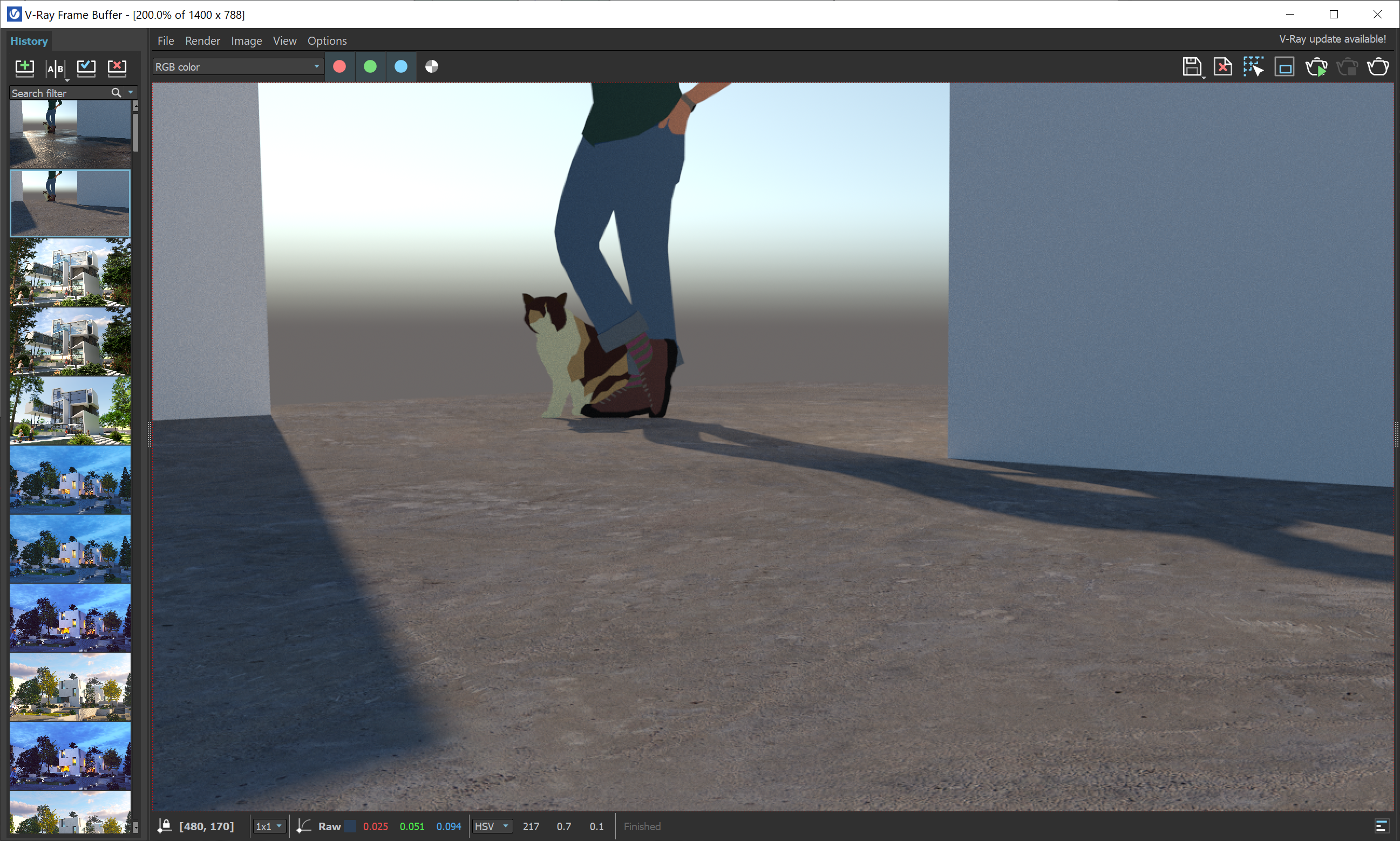

        Here's a simple concrete material from Cosmos:
        By altering the diffuse, reflection and coating of the material we can make it look wet:
        This is currently a manual process and the results depend on the time you invest in fine-tuning the materials.
        As I mentioned, it is possible that this process can be streamlined and automated in the future.
        And it's good that you are showing interest.
        I'll make sure we have an internal discussion about this and possibly raise it's priority.
