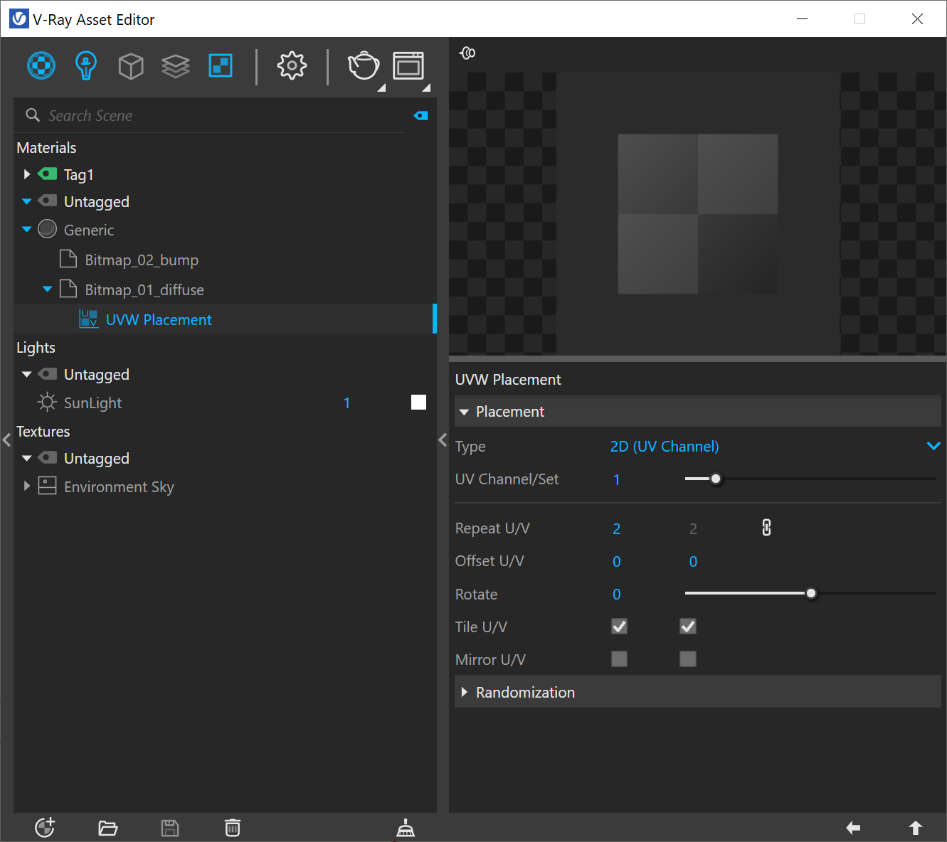

    I have a Sketchup proxy that I've brought in that has materials already mapped on it. I can easily swap out the materials on the Geometries tab, but is there a way that I'm missing that allows me to scale them? Changing the repeat on the Materials panel of Sketchup changes the scale in my rendering, but only if it's a non-proxy model. If the material is on a proxy object, it renders the same. Is there a way for me to change how that material scales on my proxy?

    If a material uses more than one texture (diffuse, reflection, gloss, etc.) that should all share a placement you can do the following:
    1. Navigate to the first texture's placement and change the Type to Mapping Source:
    2. Add a UV Placement map in the slot and set the tiling you want:
    3. Do the same for all the other textures but this time copy and paste the existing UV Placement as an Instance
    Now when you change the repetition, all textures will be updated.
    The bigger Repeat value you use, the smaller the material size would be.
    Hope that helps,
    Konstantin
