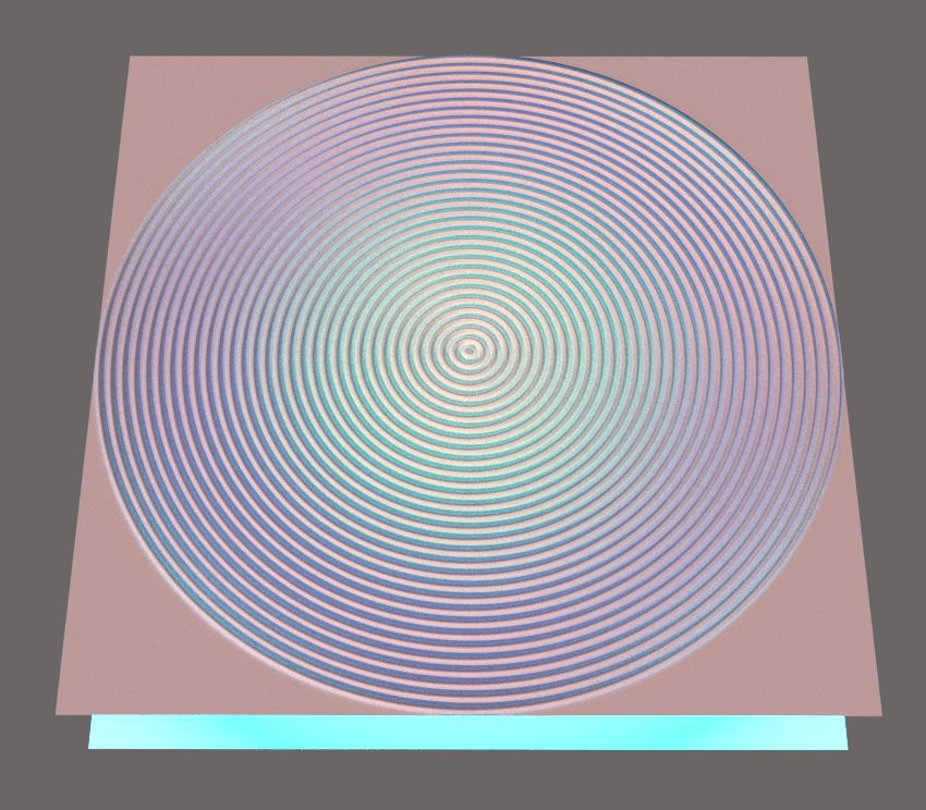

    Here I created one similar very simple example Backlit_Surface.zip . It contains a surface with Displacement and a Rectangular light with a Gradient texture under it. The material of the surface has Translucency attribute with Curvature texture, so that only the concave areas are translucent. Here are images with Translucency on the left and without Translucency on the right:
ID:	1211021 Click image for larger version
