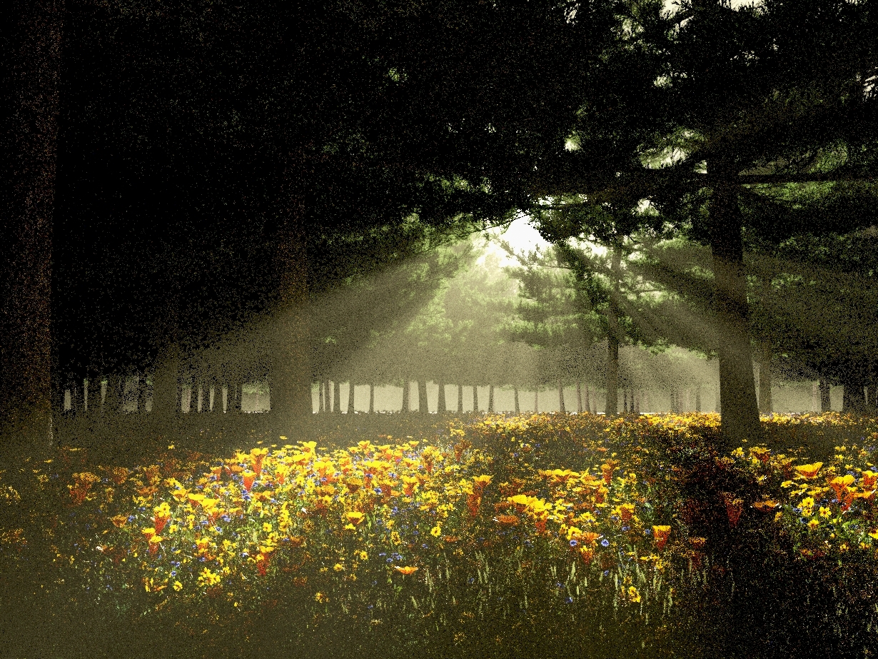

                    Well that thread solved the issue in part. Indeed, using an HDR, in my case https://hdrihaven.com/hdri/download....itou_park&r=8k was an instant success, as in this image.
                    So I spent hours trying to achieve something only barely close to this with a sun/sky, yet just throwing a random hdr in works beautifully in seconds
                    It would be cool if sun/sky worked as well but at least there is a workable method otherwise
                      so this is just a dome light with the HDR image in there, sun and sky turned off - what about the sky map?
                        Yes, only a hdr mapped dome, simple as that. I was pleased yet astonished. Everything is better, the shadows, overall lighting plus ofc the rays you needed to see
                        I linked to the map I used, which is basically what I imagine the sun/sky to be able to do with ease, as it's a blue clear sky and a bright, pretty sharp sun.
