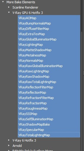

    Hi, I'm using Vray GPU to render out Bake to Texture but, I cannot seem to find a Bake Element which has the full RGB render.
    Am I missing something or is this not possible with GPU?
    Thanks, N.
    VRayCompleteMap?
      Complete Map isn't listed as an option.

        Huh, that's odd. It is listed on my end. Does it appear on an empty scene? Which 3ds Max version do you have installed?
          The baking is done with 2023.

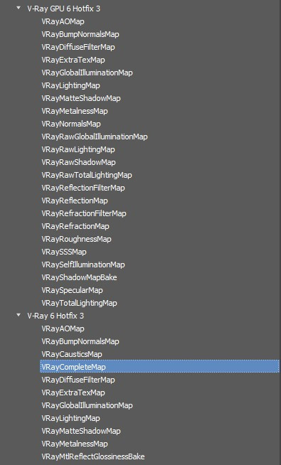

          I created a new scene and it works, merged in the old model and it works perfectly - thanks man!

            It's disappeared again - new scene doesn't help. I also opened the max file that worked yesterday but, the complete map isn't available.
            Is there anything that might cause it to disappear?
              Very odd. Not sure what's causing it. For starters, try resetting your 3ds max settings to their defaults and see if that makes any difference.

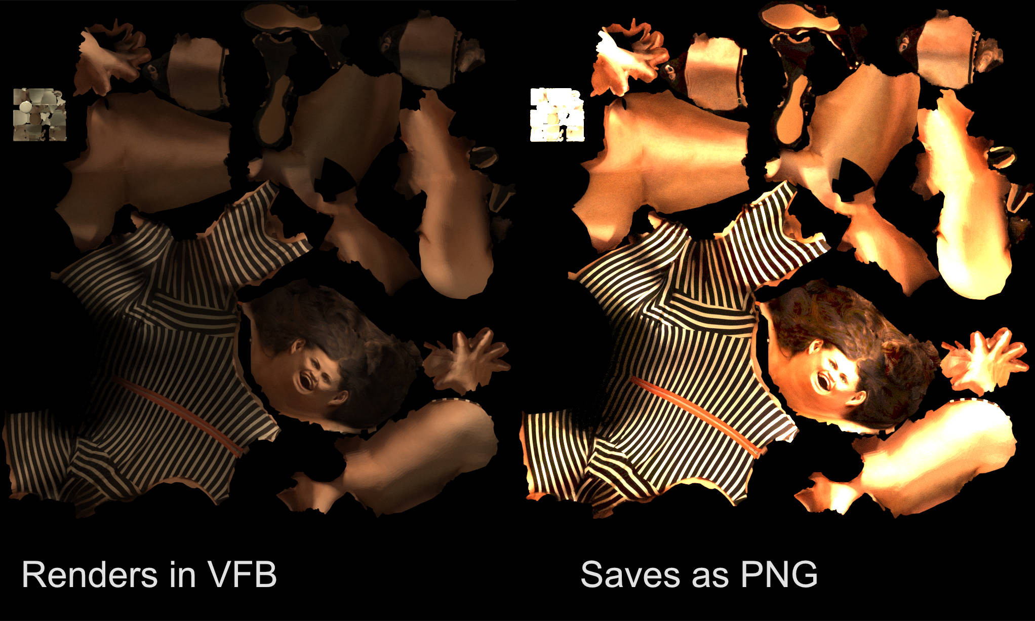

                    I'm looking at this again simply because the GPU renders 5x faster than the CPU when Baking To Texture. The issue is that the render is good in the VFB but, it saves as an overexposed PNG. Are there any reasons for this? I've tried adjusting the settings when Baking it but, the result is always the same.

                        I've sent all the info and assets to the contact form. The two issues are;
                        1. V-Ray CompleteMap is not always available for GPU
                        2. When the complete map is available for GPU, the rendered Bake To Texture looks good in the VFB but, it saves overexposed.
                        • #13
                          Thanks for the provided scene. I am still not sure what's causing the first issue so I'll continue investigating. However, I've debugged the scene and found the culprit of the second. It seems that when a camera with exposure control is set in the active view, the Exposure Control is applied only to the VFB (i.e. if the perspective view is active both VFB and the output should be identical). I've logged the issue (internal bug-tracker id: VMAX-12965) for developer investigation. To workaround it, you should use the exposure control from the Environment Settings instead.
