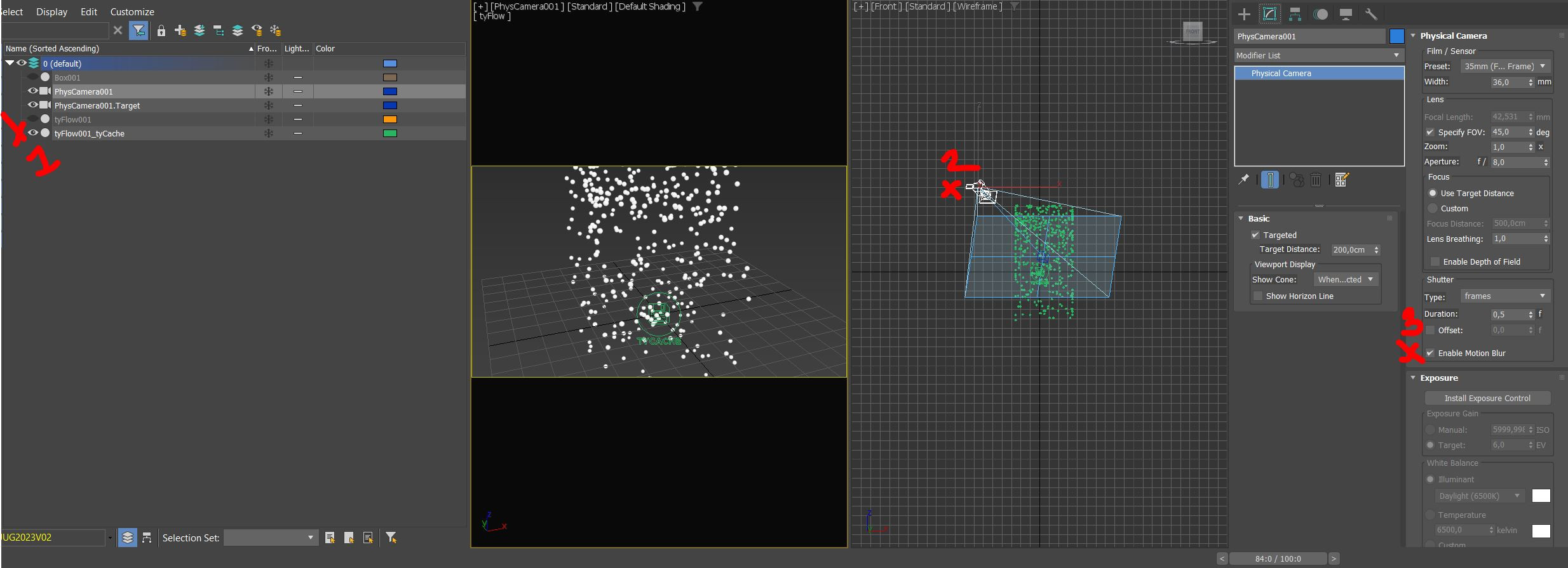

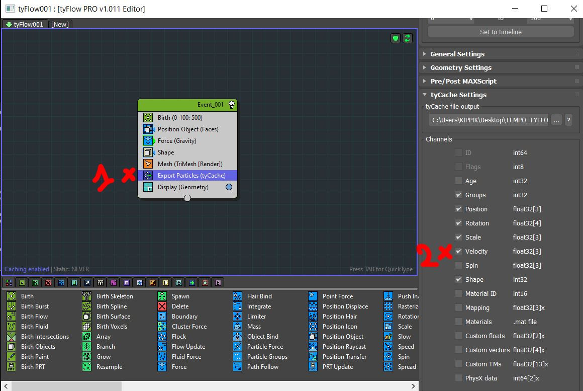

      I'm not an expert at all but we use Vray GPU (a lot) and Tyflow (sometime) and our pipe line support motion blur with Tyflow particles but only with particles cached with Tychache (not with "live" tyflow particles) it force you to cache your flow but it's not that complicated to handle.
      I don't know your level in 3D/Vray/Tyflow, excuse me if I say thing too obvious.
      - 1/ Build your flow
      - 2/ Export a Tycache with Velocity Channel enable
      - 3/ Tycache should be autoload in your scene
      - 4/ Build a physical camera, enable motion blur
      - 5/ And motion blur on Tyflow it is !
      Work both IPR and PRODUCTION render.
      Hope it help,
      Best,
      Nicolas

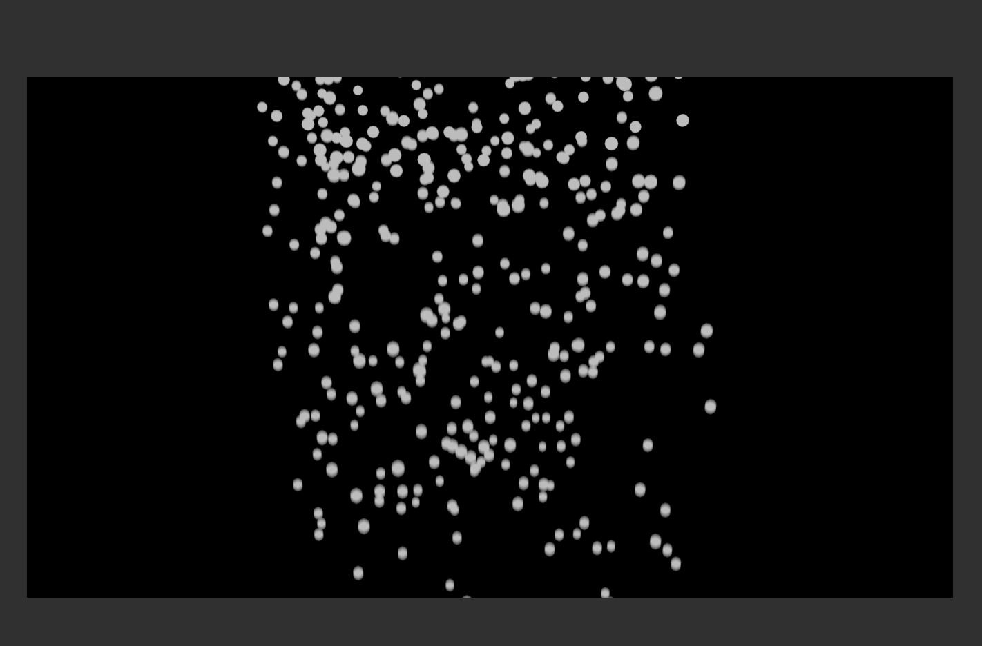

            thank you so FKING MUCH! this worked! added the export particles operator and ticker velocity. thanks so much!!!!!!

              Just realized that on IPR it only worked on the current frame, then if i go to next frame the motion blur is gone. Are you aware of a solution for this? Thanks again!
