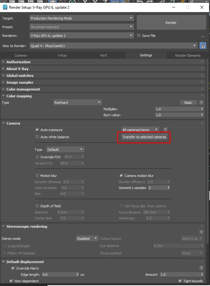

    In V-ray there is this Auto Exposure feature in render setup but is it somehow possible to see what exposure value it uses so I can take it off and use the same settings in V-Ray camera?
    Thanks.
    Hi, thanks for posting. There is a button for that - transfer to selected cameras
