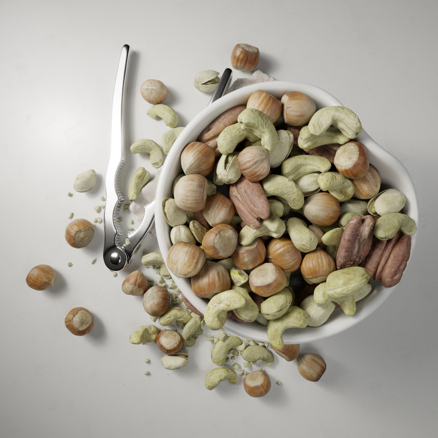

            For performance testing I recommend using longer tests, +5 minutes to get a meaningful result. It is also better to use production scenes for such comparisons, the scene you are using now has mostly empty frame, other than the statue. Here is a better scene to test with,

                          Today was the last day of my redshift software trial and tried to match your setup and I think it matches well, and the render time of redshift is 1:18 min.

                              Here are my results, with the recommended driver
                              RTX 3090: 10m 9s
                              Ryzen 5950x 16-Cores: 17m 13.1 s
                              The 5950X is faster than your 3950X by around 20%, so the difference between CPU and GPU in your case should be bigger(close to 2x)
                              Another note is that you need to adjust the bump values for the standard V-Ray CPU to match the GPU result, which will increase render times
                              I don't understand how your 3090 renders my scene in 27 minutes, something is not right! Do you have Low priority turned on for your GPU?
                              I'm using Progressive mode for GPU and Buckets for CPU, please check this article and this article about
                              You could also try to monitor your GPU power draw like this article, it should be above 300 Watts during rendering
                              If you are still getting this decreased performance, I suggest a remote session. I will take a look at your setup to see why it renders slowly
                              About Redshift, it doesn't seem to use Random Walk SSS in your setup. There is also the bowl itself, which uses Chaos Scans which adds detail and variety to the wood shader. With this being added, RS render times will be longer for sure
                              Same about Chaos Vantage, it doesn't use SSS yet
