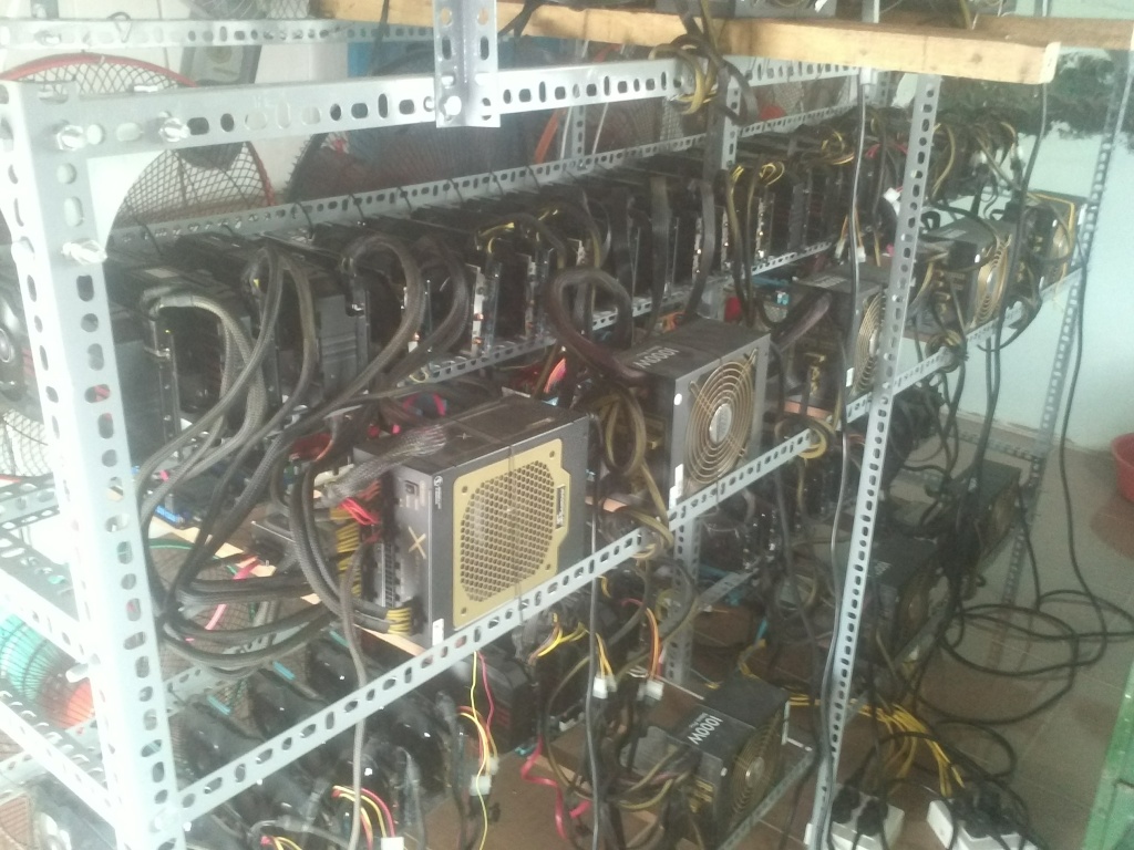

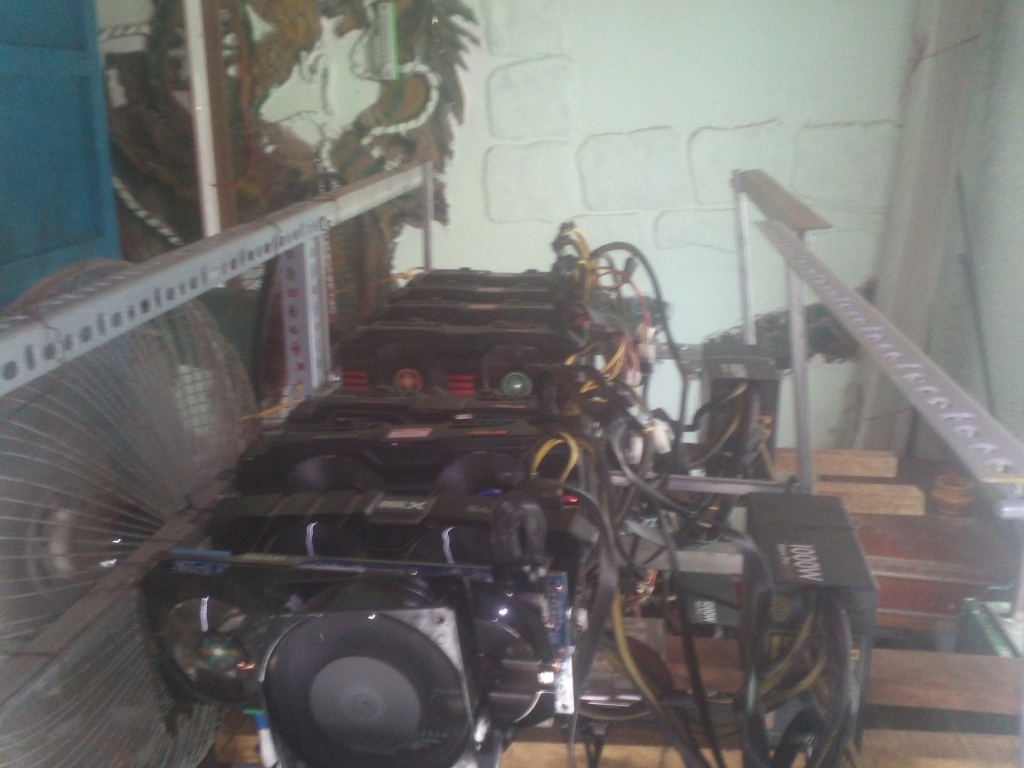

          Another dodgy solution would be to do this :
          https://bitcointalk.org/index.php?PH...opic=7216.1680

            Manu universities does stuff like that now days. Jank a shell/home made rack and spam them with GPU units hehe
              Yeah and you'll never guess what they use them for Not for scientific computing for sure...
              Vlado
                At some point it was popular to use them for producing bitcoins

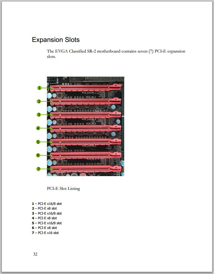

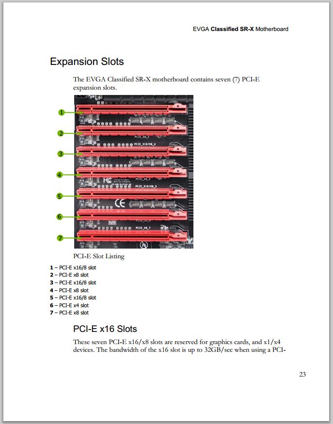

                  Hey there,
                  Well, what to say, with the new release of SP4, we are definitly going to buy some GPU nodes now.
                  So my question remains the same, what motherboard should we go for?
                  The SR-2 or the SR-X?
                  The problem with those are that they both have 7 PCI-E 16x but not all of them are 16x.
                  From EVGA's Manual :
ID:	846849Click image for larger version
                  Vlado, does that change much? Are the PCI-E lanes used at more than 50% when rendering? Should we go only for 4 GPU on those type of cards?

                      Originally posted by 3LP View Post
                      As a side note, any chance you would have any new with those benchmark Vlado?
                      Yes, the machine that we used for the Forest Pro demo has 4 GPU cards; the CPU usage for the i7 managing them was about 20%

                        • #13
                          Is RT multi-threaded in terms of handling the GPU? I guess so, but I just want to make sure.
                          Yes, it is. It's better to have several cores, the actual GHz probably don't matter that much.
                          I might repeat my self, but, do you know as well if it's a problem or if we have some performance issues if we put GPUs on PCI-E 8x?
                          I don't know to be honest; if you can make tests, it would be best.
                          Vlado
