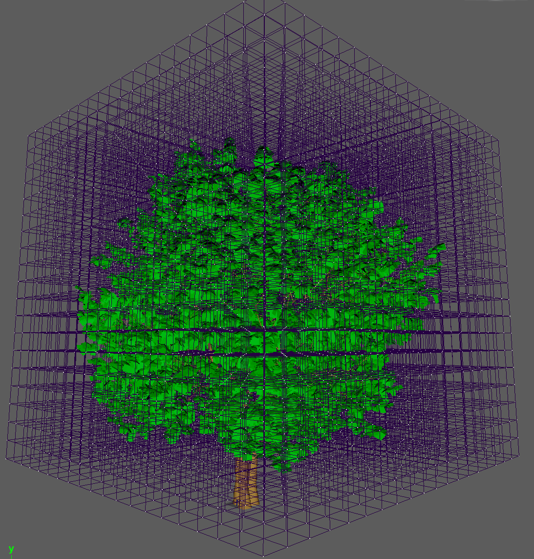

    Viewport
Name:	Screenshot 2025-05-07 215721.png

    The issue is that the particles are visible both in CPU and GPU. I presume the big chamfered square is just the GPU not handling points, but spheres, and the nucleus having a big radius for Particle Size.
    The warning messages are related to the particleSamplerInfo node - an issue (internal tracker id: VMAYA-13273) that we fixed not too long ago and is now reappearing (I'll reopen it). On a side note, the particleSamplerInfo is also not supported on the GPU.
    Either way, the workaround is to set the particle Opacity to 0 (nucleus > Shading). Not sure how you made it to work with Arnold without setting the opacity to zero; they render on my end, but with a different scaling, it seems.
      That fixed it. Thank you. I did also have to change Particle Render Type to MultiStreak for GPU. Thanks again.
