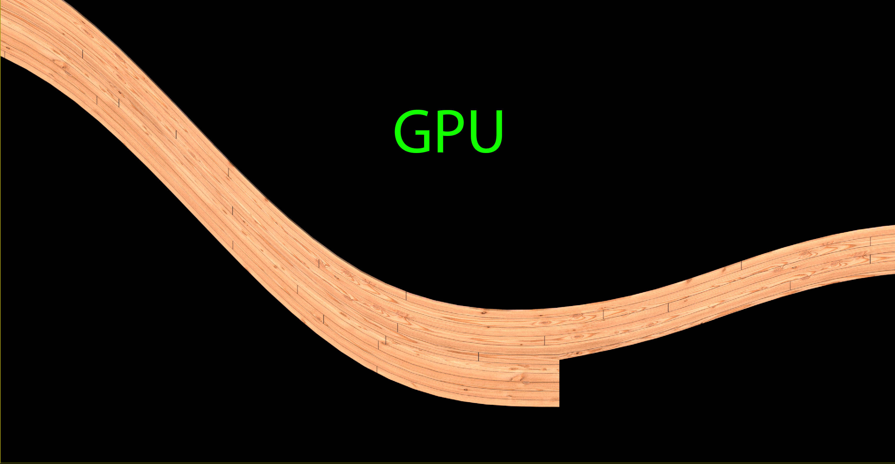

      Hi Muhammed, +1 here
      I dont know any other similar variation control in vray for this scenario (might be wrong) tiles are not geometry, but texture based, bercon generates tile ID, can be used for random offset/scale/rotate. There is some more complex approach in OSL but it does not work so well and is lot more complicated to setup - even do not know if it works on gpu. See examples below. It is very important feature for me.
      thanks, cheers, Filip
        examples above are the bercon tile map on simple two triangles plane, here is another object with the mesh screenshot.
          Thank you for explaining your use case and the provided examples, it is very helpful to us. This has high priority now on the GPU roadmap, I will see what we can do about it
