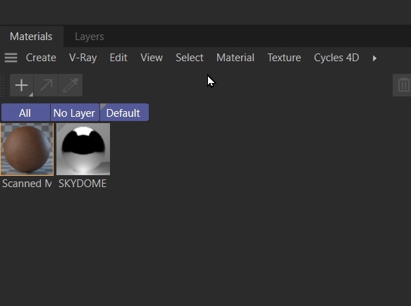

          C4D's Asset Browser saves/stores assets (i.e. models, materials, hdri's, etc.) in a local database that is accessed directly in C4D. I have included a couple of screen captures that show this. It's invaluable when working in C4D. If your team isn't aware of the Asset Browser I absolutely suggest looking to integrate VRay's material presets in a way that will work with the Asset Browser. If there's anything I can do to help please don't hesitate to ask.

                Ran the test - loaded vrscan file (leather in this case) in to the C4D Material Manager. Everything works, although the process of using vrscan files is really not great (see steps below). Once loaded in C4D, copying the Scanned Material in to the Asset Browser transfers everything but the texture image(s). This breaks the preset functionality I'm afraid since texture images (i.e. diffuse, bump, etc.) are also copied in to the Asset Browser database. Currently it seems only the Scanned Material shader sees these files.
