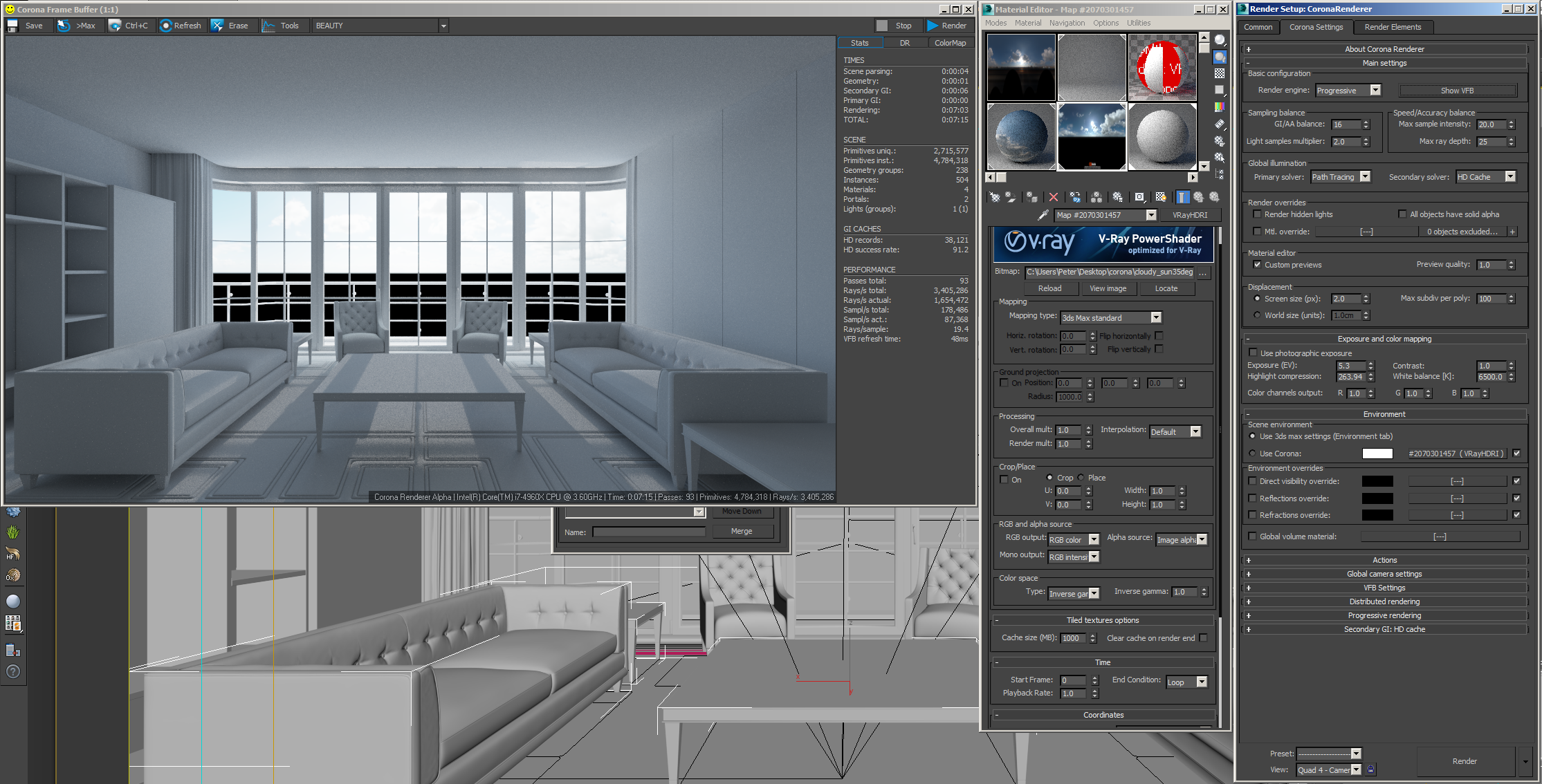

I am looking for a workaround of the burned sky when using HDRI as the only light source in interior renders.
Highlight compression can’t seem to fix this to full extent. I attach screen grab - all default settings, map loaded through VrayHDRI in Corona Environment tab.
Thanks for your time!
Peter
There are several methods.
  1. use direct visibility override in corona settings>enviroment
  2. save as 32bit file and use local tone mapper.
  3. save alpha channel and replace sky in post.
    4…
Brilliant! 1 was exactly what I was looking for - control and positional accuracy. Thank you!
