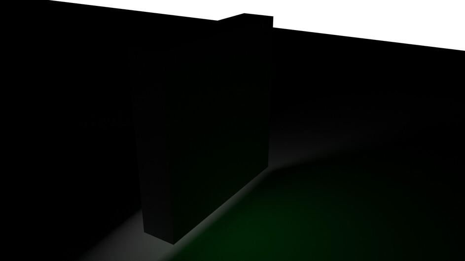

I appears the new translucency options just introduced in ver 5.1 do not render properly in Vray GPU mode, I’ve attached some sample renders and a sample scene, thanks!
SSS.zip (59.6 KB)
Translucency is one of the few mtl features not supported on gpu. Here is the full list of supported features
@scott_canuel Yunal is right and the new translucency isn’t supported by V-Ray GPU. The old one wasn’t supported as well and if you want to use translucency with V-Ray GPU it will be best to use the FastSSS2 or the AlSurface materials since they’re supported on the GPU engine. We’re working on making the unsupported by V-Ray GPU parameters hidden for all materials like we do with the Render Settings. This would make working with V-Ray GPU a bit easy when it comes to unsupported features.
