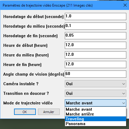

You can then play with several parameters which will be used by Enscape to create the animation :
Timestamp in second, which is transition time between each interpolate scene
the hour of the day with 3 values possible for visual aspect of the animation :
Start, Middle and End hour, which can simulate time passing along animation.
If start, middle and end hour have same value, hour the day will not change during animation
3 camera options (shaky camera, smooth transition and FOV).
Forward or Reverse animation, (animation start from first page to last one or from last page to first one )
The XML VideoPath file created will be then saved in a sub-folder created in the folder where the model is save.
You have just to import that file in the Enscape video editor to create the animation

You have to create first an animation camera path inside sketchUp ( should be a polyline), and launch the plugin after having selected the camera path created,
A keyframe will be created at each nodes of the path with two options for the camera target
First target option is Camera path node
Second target option is a Single point
To create this single target point, you just have to place in the model a simple component which will be used as target and his center point will be used as the camera single target point.
Then you will have to proceed same s for First way above for all other parameters

Hello
The SJ XML To Enscape Path Video , in action with multiple video paths.
This video mixes video trajectories, tracking shots, forward, reverse and panorama.
They are generated by the plugin after selections of the path curves and needing, for the traveling, a target component, and for the panorama, a component, corresponding to the position of the camera.

Step 2: Converting a selected curve, or a curve and 1-3 target components, into a video path group.
After having filled in the parameters, at each point of the curve, a camera component is placed and oriented according to the parameterized trajectory mode.
A scene with a style is created. The video paths layer is activated on this scene only. The new scene is not added to the animation.
