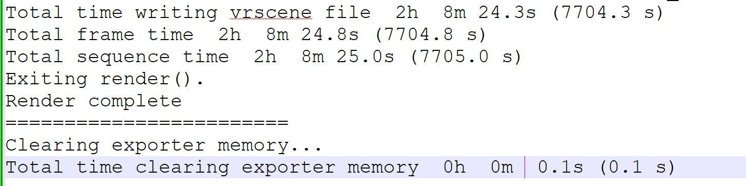

    I can not longer submit jobs from Maya vray shelf.
    Writing scene to VRscene file now stops at 99%​ followed by Maya just stalling and never completing job.

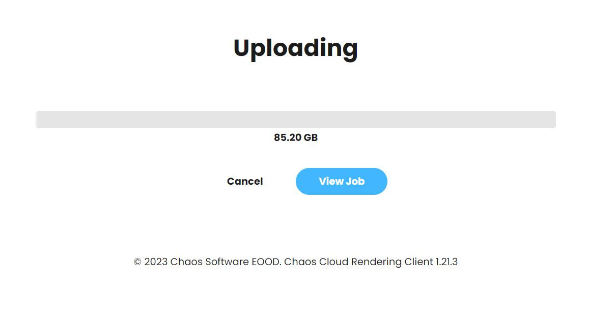

    Uploading the VRscene works fine via the cmd cloud exe
      OK it finally resolved after an hour of leaving it but the VRscene file was 85GB upload for a single scene, so had to cancel that.
      Saving the scene out to local folder was only 49Mb. I'll keep playing around.

          Saving a VRscene to local project takes about 3 sec to save but the shelf submit to cloud button takes over 2 hours.
          Also the size is incredible when it did complete, there is no animation in scene just single render.
          VRscene size when saved out was 49MB.

                I'm still getting this issue of submitting to the cloud via Maya shelf - but only on scenes that I have worked on for sometime. I cant pin point to a particular part of the scene that is causing this. This happens to all vray builds that have scatter, including the latest stable version, build without scatter seem fine.
                I not using any scatter in my scenes.
                If I send to cloud via shelf button the "writing vrscene file" takes about 2 hours and is massive in size even for a spinning cube over 100 frames, like 86GB once complete but the saved vrscene file is only 2MB!
                I can manually send the vrscene to cloud and this is fine.
