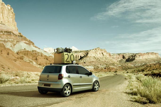

I have been practicing on this first composite of mine for about 3 days. I feel like I'm getting close, but its still not looking right. I have a vray light on the other side of car about the height of the street lamps, I have two targets, one for each tire and rim, because they weren't getting any light.I excluded everything else from them. I tried to use a night time hdri, but it just rendered the car black, so right now im using a dosch hi res daylight hdri in the gi environment override. I, I'm also getting lighting down in the grill which I don't know why, because there is a cover on the bottom. I am hoping my AO pass will hide that, But I would really appreciate any help I could get to take this thing to the max.
one more question, how can I get my matte ground object to receive reflection, I tried in the matte object settings, but it's already set on 1.0, so I don't know what else to do.
Thanks so much for any help
