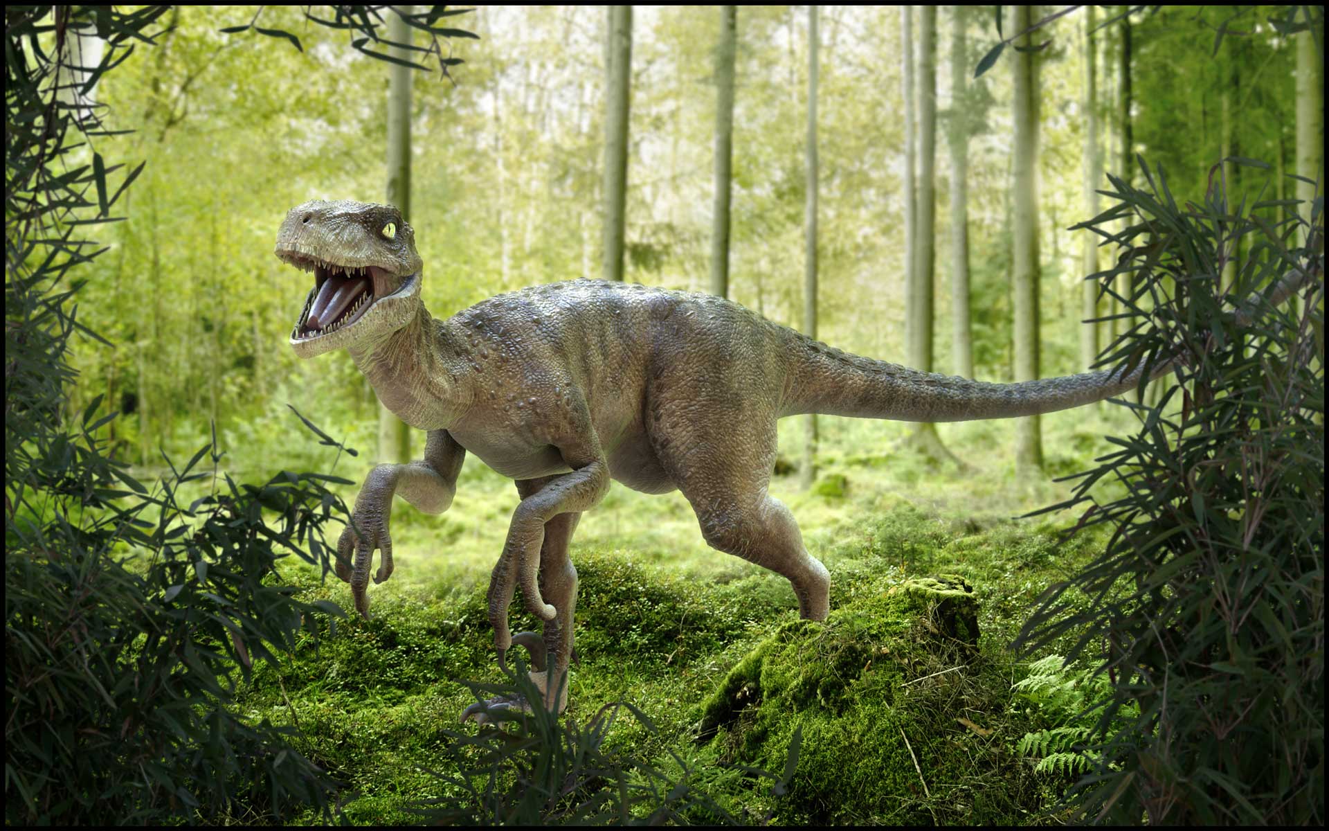

Here is also a standalone render I put together in photoshop.
