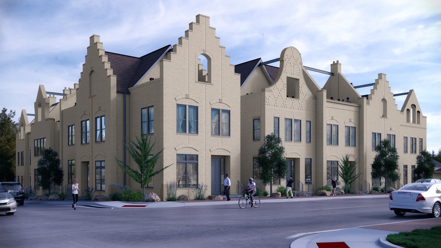

I would crop away some of the ground and give it a bit more sky. Also some warmth in the sunlight could help.
Are the trees requested by the client? If not maybe change them too... other than that I think the image is alright. The design on the other hand is by far the worst ive seen in a long time!! Looks like a movie-set with those fake facades.
I don't think the blurred background is helping at all, and I agree with the tree comment; they look really weird.Check out my (rarely updated) blog @ http://macviz.blogspot.co.uk/

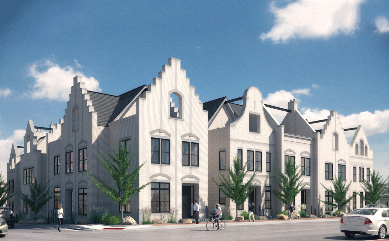

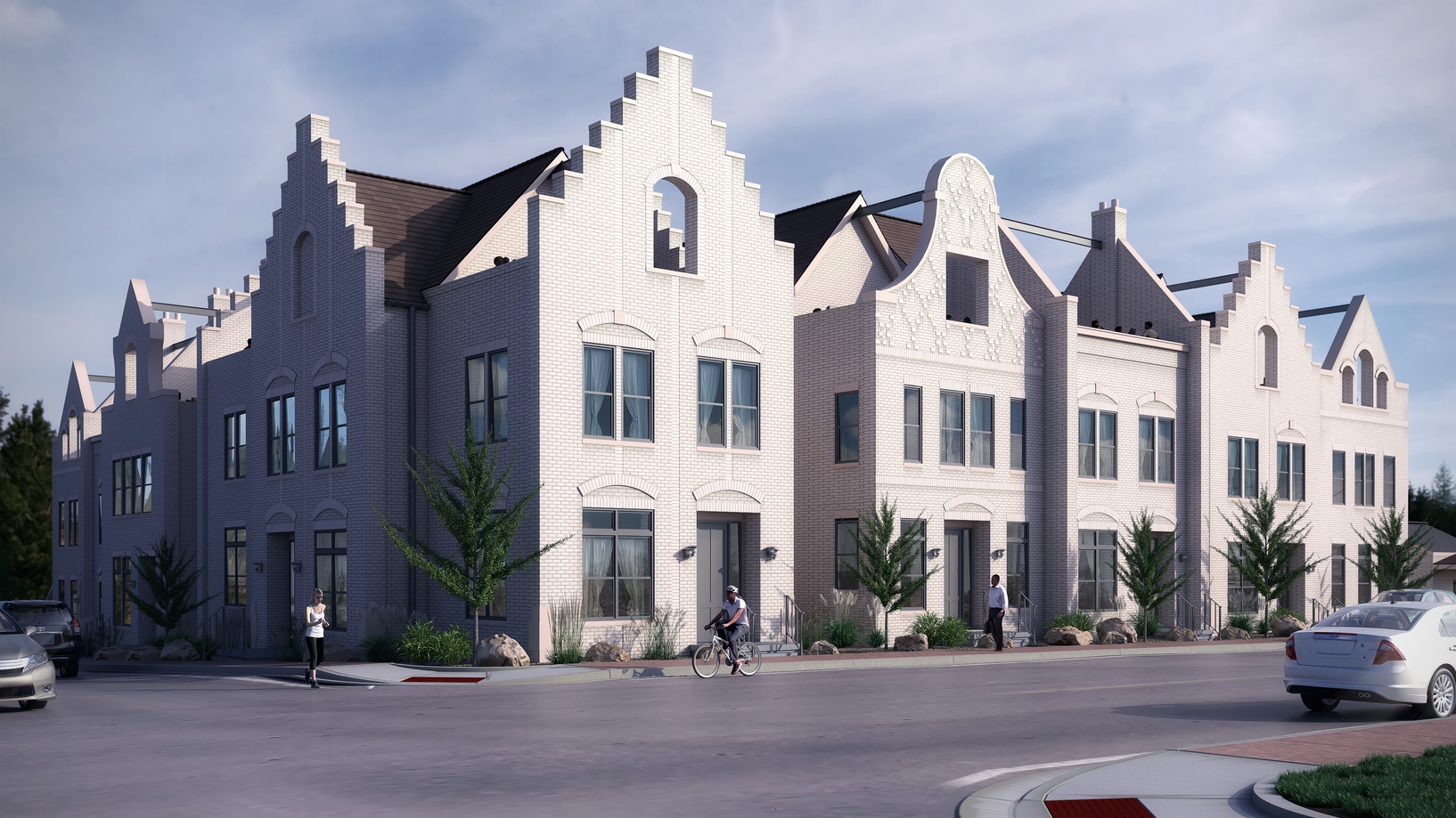

Originally posted by flino2004 View PostIt looks better but the people look out of place. The runner and the guy with the bicycle are in the middle of the road and hooker is in the middle on the block....the paparazzi who knows.Bobby Parker

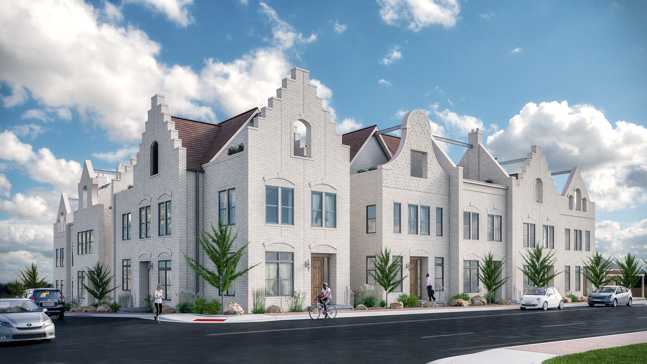

It's getting better, but IMO
-All of the cars and people are not helping at all in this view. The people upstairs are quite distracting like cut off very dark heads, just weird.
-Grass on right needs material work (try using area in edge mode instead?)
-curb behind that grass is razor sharp
-road look like a lo-res Google map
-loose all of the strange trees, they look so odd
-detectable surfaces and sidewalk materials need improvement
-Is the view locked in by client? If not, consider stepping back a bit.
Sorry for all the things, it looks like a challenging design to work with Keep up the good fight!
He insisted on the trees. I tried swapping them, but he wanted them back. I had the camera back a bit, but someone else on the forum suggested I bring it in; I am indifferent and slightly prefer this one. He wanted the people on the roof, but I agree, they look odd.Bobby Parker

I absolutely hate that request! it's a very technical, almost CAD jockey, mistake.Originally posted by voltron7 View Postwell, in the end, the client's the one paying...so it's on him, lol.
I feel ya, I just had a client demand the "raise the camera about 30-50 feet up." Guess they really wanted to showcase the lovely EPDM.Bobby Parker
