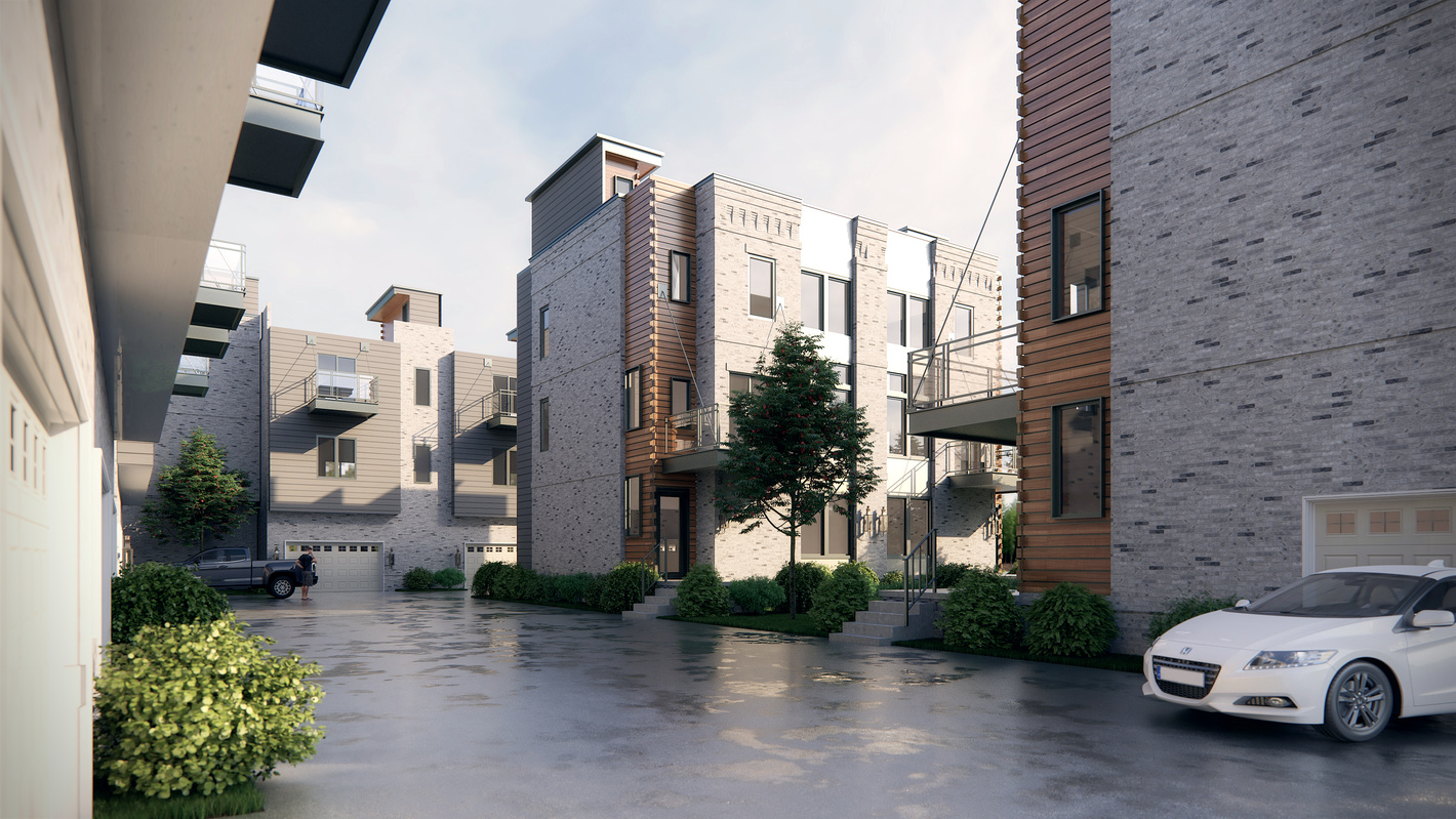

                Interesting project. The original architect sold the project to a developer and the developer ended up buying more land around the original site. The first project only showed the front, so that was the only thing modeled. I didn't have plans for anything but the front original, so everything else I had to make up. Anyway, here are some new image, for the new development.
Name:	4th & Garfield - update 1 .jpg
ID:	862647 Click image for larger version
Name:	4th & Garfield - update 3 .jpg
ID:	862648 Click image for larger version
Name:	4th & Garfield - update 4 .jpg
                Generally, I don't have so much shadow, but I wanted the front of the buildings in light, which is the only interesting part. The shadows hopefully hide the boring large brick walls.

                • #23
                  wow! amazing work

                  • #24
                    Well, I wouldn't say that, but they turned out good. I sent them off to the owner today, Usually, with this client, there is always changes

                    • #25
                      Holy Cow! No changes; just another view request.

                      • #26
                        looks great! your a lucky man

                        • #27
                          It is rare, but true
