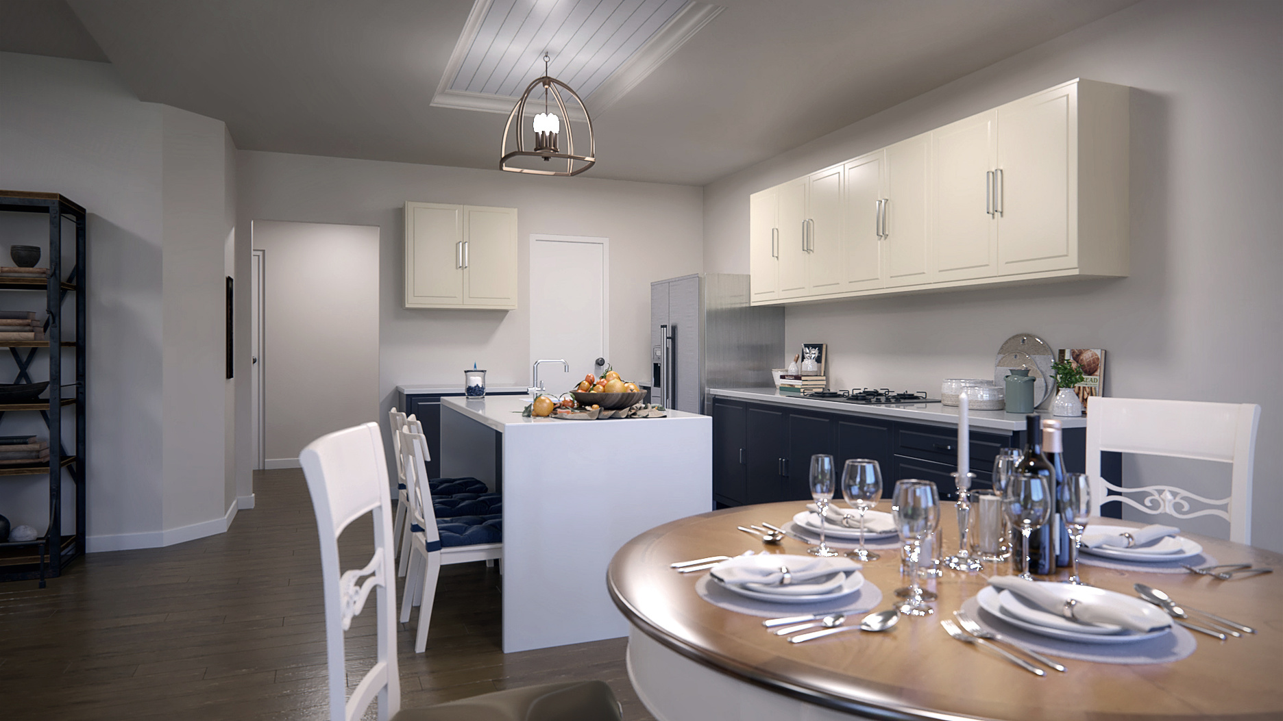

    Some interiors. I tried to use the Bloom/Glare, but really couldn't get anything good; these do not have it. I am seeing a lot of bright spots, which I don't usually get. Should I clamp?

    Space is pretty boring. No backsplash or real color, but it is to their specs, and they approved it up until today's furniture and clutter.
          On the plant in the second image? Those look odd and I would like to take a look at that object/scene if possible.
          It would be really nice if vray bloom/glare would interactively update as you spin the settings
          They do this in the latest 3.5 beta and they are quite a bit faster too.
          Vlado
            At a first glance, those bright spots look like error in material setup, specifically glossiness.
              Nice images.
              Try subpixel mapping first, if that does not help - clamp, that should work.
              Available for remote work.
              My LinkedIn: https://www.linkedin.com/in/olegbudeanu/
                Updates. Subpixel Mapping fixed the bright areas. I did have highlights that took a long time to process. The V-Ray bucket sat over a few for about an hour.

                These are 1/2 resolution and took a little over an hour. Full sized will be 4X that, which is concerning. I did some things that I know slow it down, but the subtle color from my HDRI is worth it, I think. If I were to post this I am sure the first thing people would say would be to get rid of the HDRI and use a V-Ray Dome/Sky.

                  The fireplace in the 1st version looks closer to real. The 2nd one is way too bright
                  Kind Regards,
                  Morne
                    since you have few windows I would use simple vraylights (planes) instead dome or hdri.
                    you missed the top drawers on the lower cabinets.
                    show me the money!!
                      Agreed. I'll spend more time balancing things out for the finals.

                        are you using arion fx to process the images? maybe its my glasses but seems a little burry i can't focus on the image, maybe its my glasses but none the less love it! the decore is really simple and nice

                          Oops... I missed that.

                            Yeah, I noticed that, but blamed it on the low resolution
                              Just so you know, for V-Ray 3.6 we plan to use the adaptive lights framework to speed up rendering of dome lights quite a bit.
