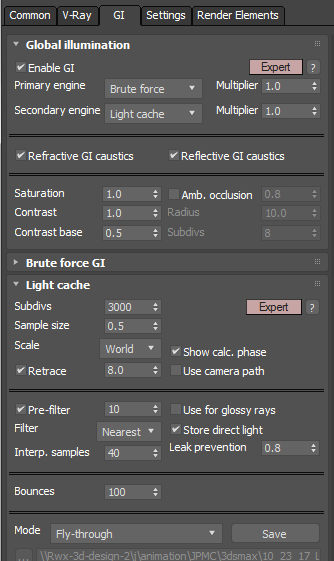

                Well I have spent a good portion of today working on this and I think I am more confused than ever . I have enclosed my settings and a very short animation) as you can see its much better but its still a bit noisy and flickering esp near the lights over the bar. Good news is the frames are not taking a crazy amount of time ( roughly about 14min a frame ).
                Not sure what settings to change to clean it up. I am also using the denoiser with this.
                Thanks
                Alex

                  Max subdivisions on 100 is from some very old methods, bring it down to 4 or 6 and raise the minimum shading rate to remove noise.
                  Noise threshold is weird too, leave that on default.
                    Just revert everything to defaults, set the LC subdivs to 3000 and retrace to 8. Nothing else. There is no need for world-size light cache samples and fly-through mode; in fact this will probably make you scene render slower. Interpolation samples at 40 is way too high and will slow down rendering considerably.
                    All in all, a very educational example of why we should remove these options from the UI completely
                    Vlado
                      I am all for removing (or hiding) legacy stuff that is no longer relevant to today's workflows. Bit of spring cleaning is in order
                          Vlado
