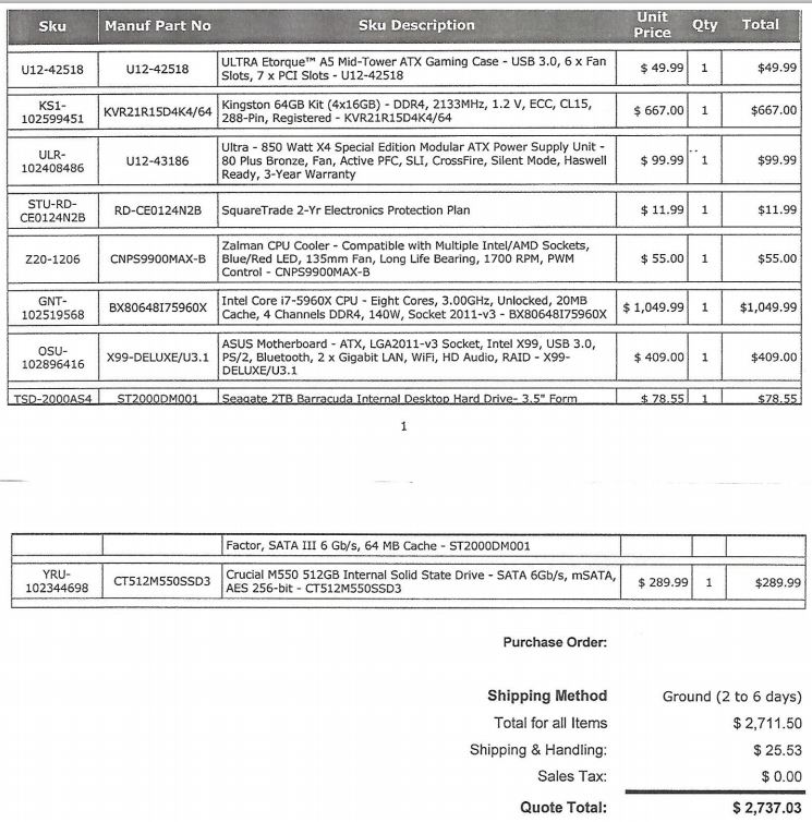

                  • #24
                    I have some converging deadline, so I have to update some hardware to keep up. With feedback from you guys, this is what I have; what do you think?

                    • #25
                      Looks pretty standard to me...shouldn't have many issues.

                      • #26
                        Not thrilled about your cooler. Not sure how it would perform if you oc the cpu. Also I would suggest looking at the Fractal Design Define XL R2 Black Pearl E-ATX Tower Computer Case. Its a good case with sound proof material so very quiet inside.

                        • #27
                          Yeah, case is definitely lacking...I wasn't sure about whether he was going to OC or not. If he is...DEFINITELY need a better cooler. Noctua or Corsair Water cooling (about same price) are the way to go. Simple, yet effective.

                          • #28
                            What about these for a cooler and a case? I've heard pretty good things especially if the 5960 is overclocked.
                            Corsair Hydro Series H100i GTX High Performance Liquid CPU Cooler
                            Cooler Master HAF 912 - Mid Tower Computer Case with High Airflow

                            • #29
                              This is costing 2X what I currently have, so I'm expecting it too be 2X faster . Currently, I have the dual Xeon with 32 GB of RAM. I'm recycling my video card, but that cost isn't considered in the price comparison.

                              • #30
                                Look at benchmarks...if trying to keep to a budget...I would look at the 5930K processor...it's almost half the price and you may only sacrifice 10-15% at most...and due to the higher per core clock speed, the 5930K will be faster on any single threaded task. Just a thought to save about $500.
