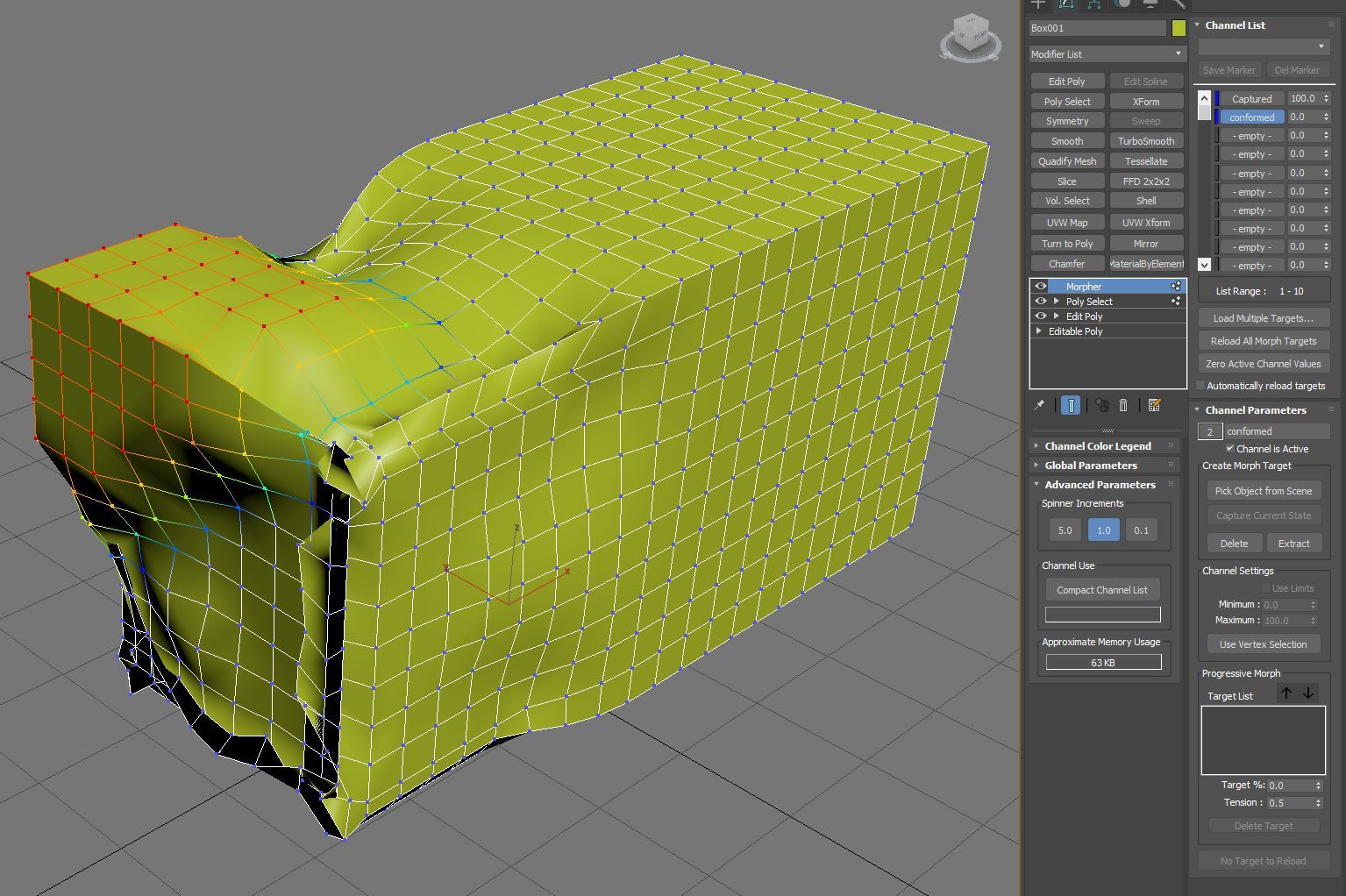

    morpher modifier maybe?
    conform brush is in edit poly mod.

      Hmm...I'm intrigued by the problem but don't think there's a modifier solution to be honest. ZBrush no doubt is a good option if available.
      One suggestion (although I don't know the model type or what sort of shape or deformity you need to add) would be to create
      a separate object with the correct vertex count as your outer ring, then attach it and smooth that intersection as needed. Conform as a sub-stage could help if it's really awkward I guess.
        is it possible to use a lighter version of your high res mesh then later skinwrap-morph into the final shape?
        Not sure if you have tried that but under soft selection settings you can tick " Lock Soft Selection" so it will stay the same even after changing the shape..you can also use paint/bur to adjust the transition.
        If you have access to Zbrush it might be easier to do this with it ..Match Maker brush might help here.

            I would look into this MCG modifier that does support face normal conforming, i don't know offhand if it supports stack/soft selection though. http://www.scriptspot.com/3ds-max/mcg/va-mesh-conform
