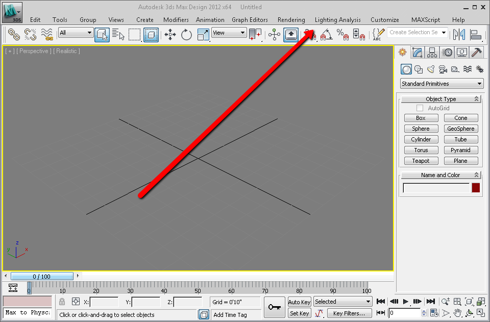

      I work in a lighting design studio and was hoping that i'd be able to use something more friendly than visual or agi32 I don't like the mental ray thing, and i got them to buy vray.
      How do you access this tool?
      Dusan Bosnjak
      http://www.dusanbosnjak.com/
        it's in MAX Design, and it's in the top pulldown menu.
