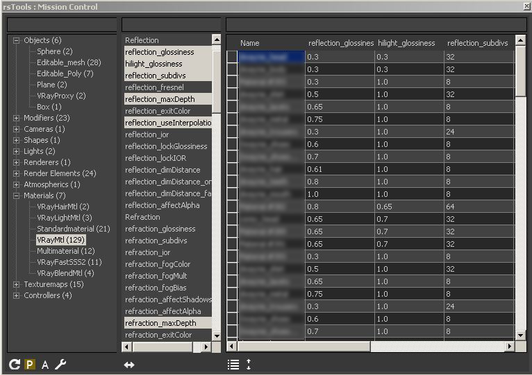

    Sounds interesting. Is this based on a .net DataGridView?
    Dan Brew
      I'm glad you're interested!
      It is a combination of splitcontainers, treeviews and a datagridview.
      Here's a screengrab.
      The parameters treeview (middle) is collapsable as once you've setup the parameters you typically want to work with you won;t need it cluttering up the ui.
