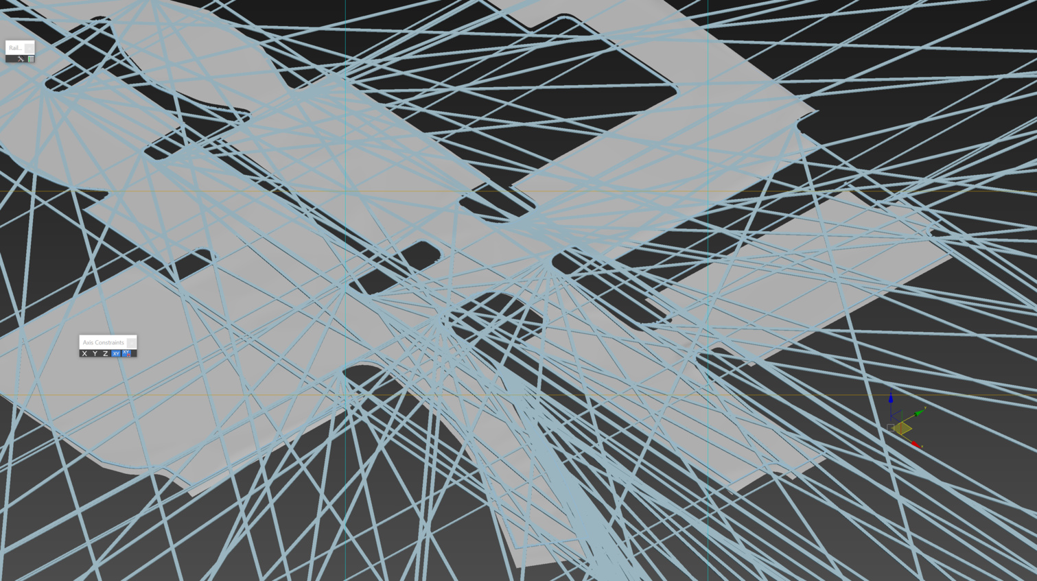

    I posted to the RailClone forum, however, he seem to reply next day. I have a spline, which I made from my road. The spline is thousands of segments, but I don't remember that being a problem and everything is clean. When I try to add a curb, I get this.

    This seems to be a problem with the xform of the different spline segments.

      I got a response from their forum and there is a known bug and they sent me a patch, however, it didn't help.

        Have you tried to reset the xform for the splines? It really looks to me like the axis are differently rotated.

          Yes, and it didn't matter. They gave me the wrong patch, so I am trying the new patch they just posted.

            I did, but it didn't matter. The new patch they sent solved the explosion thing, but not the flippy thing.

              What if you reverse the segments that are flipped?

                They randomly rotate at arbitrary angles. It just a spline made front a clean site plan.
