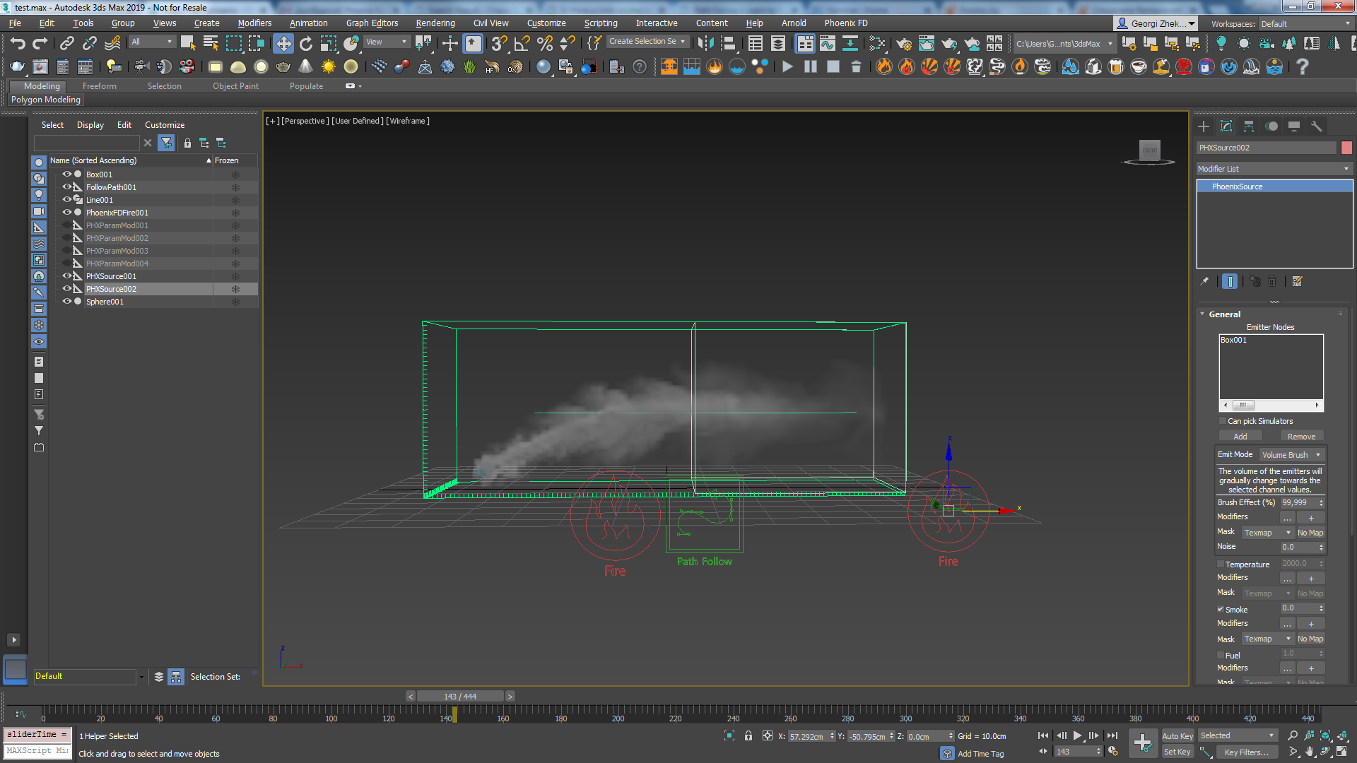

              Hello,
              You will need to tweak a few things - the box size should be a bit larger so it can fade the smoke better, the brush % for the source should be a lot higher in your case - I have set it to 99.999%.
              Also if you don't wish for the grid to expand - just disable the "Adaptive Grid" option in the Grid rollout. You can find more about this here - https://docs.chaosgroup.com/display/...d-AdaptiveGrid
              Here is how the scene looks with the changes.
