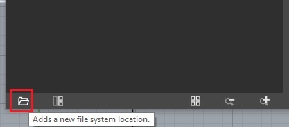

    1. Create a new folder for your Environment map assets at a predefined location.
    2. Open the Asset Editor's left-side Library panel and then click on the bottom-left button to add the folder you just created.

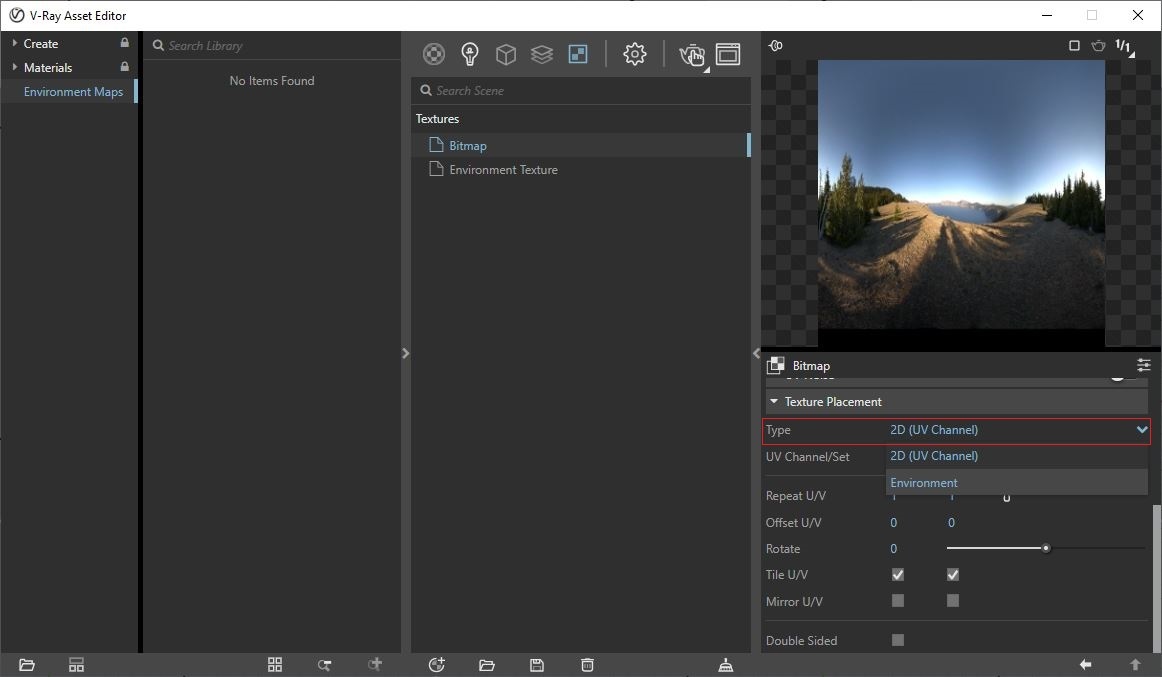

    3. Create a Bitmap texture, slot one of your HDRIs within and set the Texture placement type to Environment Spherical.
