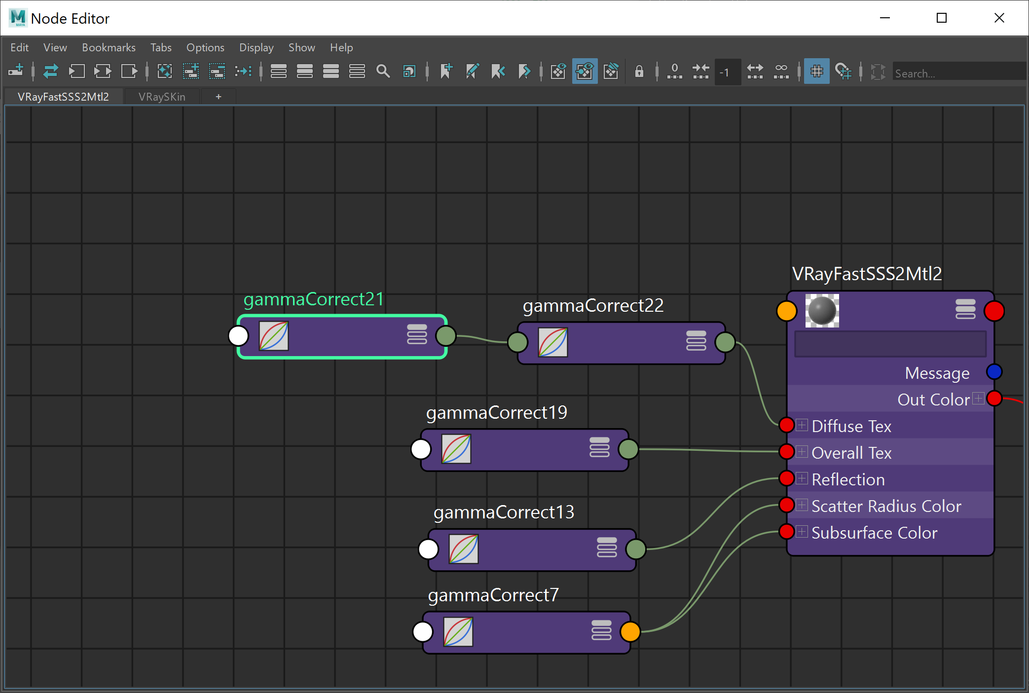

                Hi Alex. I have been helping Stephen figure out the best ways to convert our current linear checkbox 'On" assets converted to work with the checkbox off. For the most part we have just been able to insert gamma correct nodes (of 0.454) in front of the correct inputs, using the ones you have listed in your post.
                Everything seems to work as expected except for FastSSS2. On FastSSS I am not quite sure how to properly correct 'Overall Color' and 'Diffuse Color'. Using the normal correction methods doesn't seem to be working for me. I tried using a correction of 0.227 on the Diffuse since it seemed like it might have been doubling up on the Overall Color value, but just wanted to ask to see if you could provide any more insight into how we can properly correct for it.
                I attached an example scene. The scene has two render layers setup (legacy render layers) that have the linear checkbox enabled/disabled. We are testing inserting Gamma correct nodes into the basic shader setup to get them matching between render layers. As you can see the FastSSS2 setup isn't quite matching. I am guessing there is just some additional math that is going on that we need to be accounting for.

                  I haven't had the chance to confirm this with the devs, but yes, it seems that there is some doubling up on the diffuse color. Following your logic, though, I was able to get a visually identical result with a doubled up gamma correction (0.454*0.454=0.206116), in essence gamma correcting the gamma correct.
                  Is there a reason why you can't use the Maya color management for this? I suppose you're trying to perfectly match your assets, but I get the feeling that in this way you are going to get wrong results wherever the linear workflow option would produce wrong results. For example, the maya color swatch should already be providing the correct result in the correct color space, but LWF would correct it regardless.

                          I just added an extra gamma to the diffuse texture and kept all gamma nodes at 0.454
                          It turns out that FastSSS2 has an extra Linear Workflow attribute, enabled by default.
