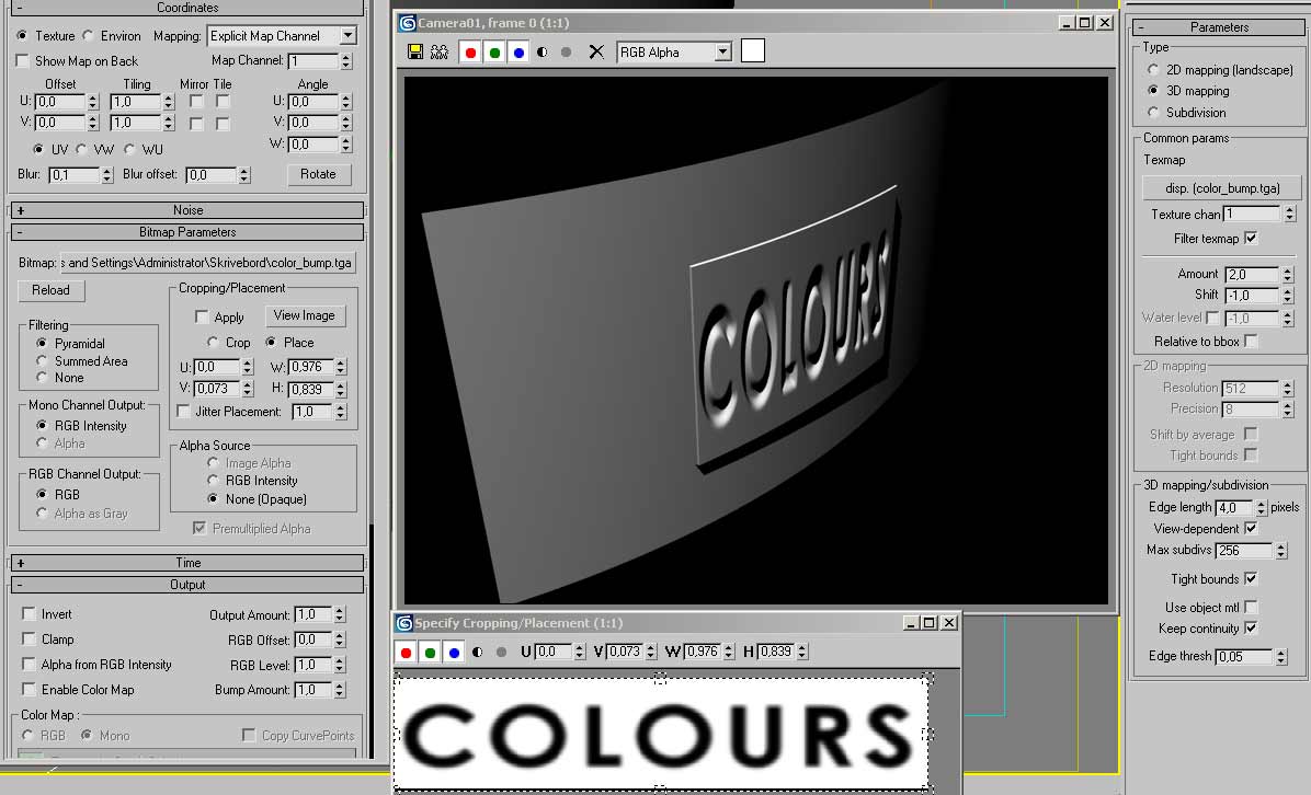

I am facing an annoying little problem I cannot seem to get my head around, when using Vray displacement.
My goal is to engrave a text-logo into a perfume bottle, and the problem can be seen in this image:
(sorry for the large image, but the text was pretty hard to read when scaled down).
-On the left you can se my displacement-bitmap settings.
- In the center you see the framebuffer - and the problem.
- Below the framebuffer you see the bitmap-image used to drive the displacement
- On the right you see the settings of the Vray Displacements modifier.
The problem is, I cannot in any way seem to get rid of the border that the bitmap creates. I have tried all the combinations of settings in the modifier and the bitmap windows that I could think of, but to no avail.
Anybody has any suggestions? - would be very much appreciated, as I am soon about to begin work on my final project for school, and need this feature pretty bad.
Thanks in advance !
/Dan
