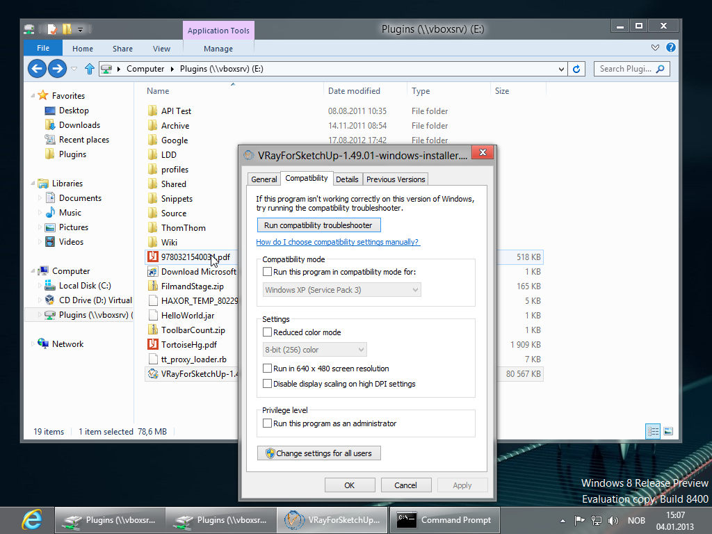

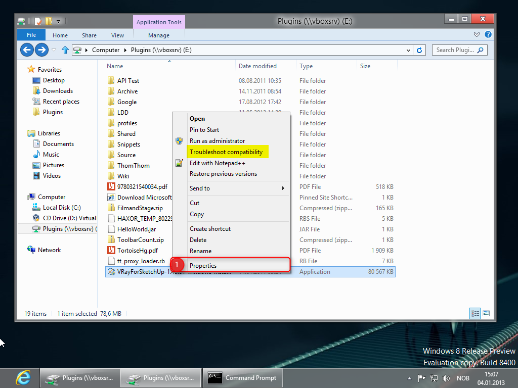

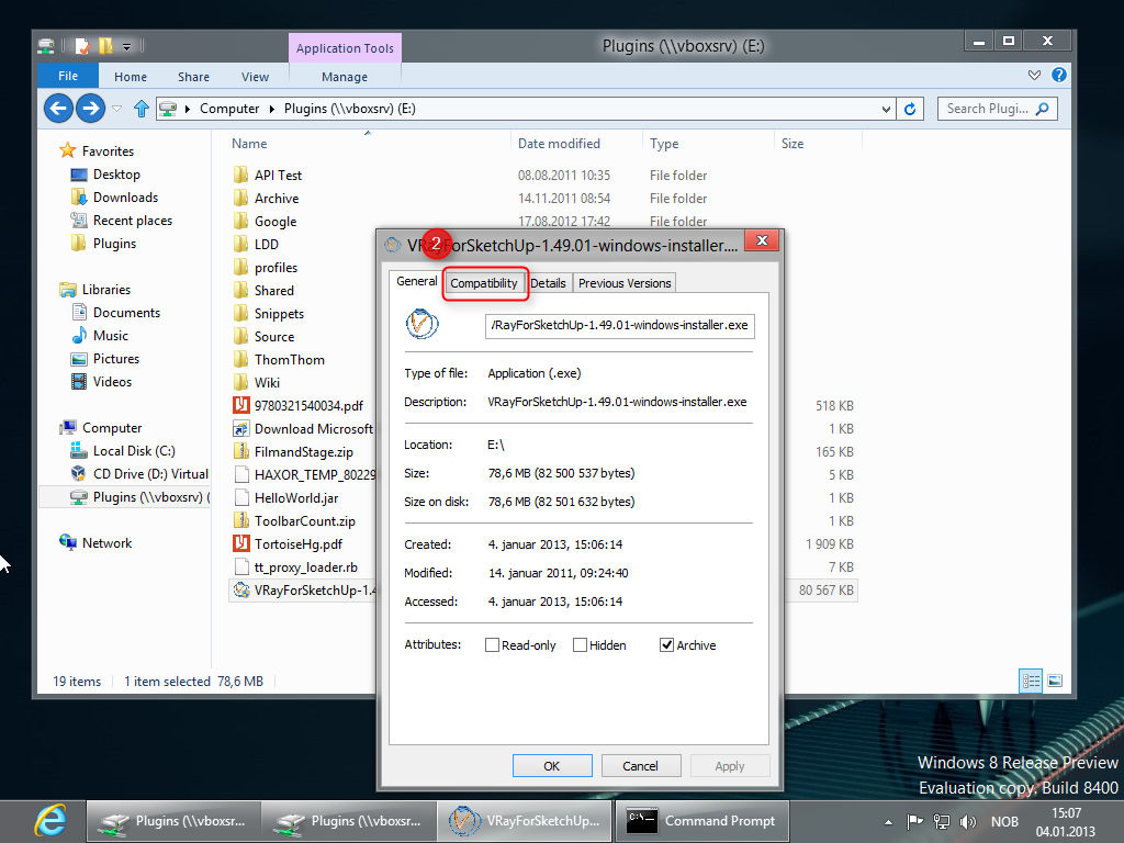

          Hmm. Tried this and there is no Compatibility tab in the window. Is there another option somewhere to find this?
Name:	01 - Menu.png
Name:	02 - Properties.png
Name:	03 - Compat.png
