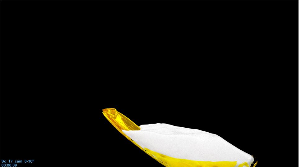

    i was following the beer tutorial and i couldn't find a way to control the foam density.
    in the tutorial we see a lot of big bubbles floating on the surface. in real life the foam is very dense with no floating bubbles.
    how can i achieve that?
    i've attached a JPG with the final result of the beer tutorial and a footage of reel beer with foam.
    thank you very much in advance

      thank you for your replay.
      i wasn't talking about the deformation of the bubbles but on the density of the foam head.
      i would have upload a picture to better show what i mean but i don't have permission to upload photos to this forum. can you make this option available for me?

        the density is controllable by the bubble size parameter and the birth rate. the beer sample (this image is from the old sample scene) uses not too big particle count, because it may become too slow for rendering and simulation. if you want denser foam, you have to increase the birth rate, to decrease the bubble size, and to increase the b2b interaction value. but be careful, the calculation weight increases very rapidly. for example if you decrease the bubble size twice, you will need eight times more bubbles in count to cover the same volume. this means eight timer slower calculations. but it's not all, perhaps you need to double the b2b interaction strength, that may lead to sixteen times slower calculation.
        you can try the nightly builds, where we have some improvements in this direction, mostly targeted ti the b2b interaction speed. with the nightlies you can achieve the same effect with about 5 times lower b2b interaction, that allows bigger density in the same
        simulation time.

          here is a link to the image that i was trying to upload;
          http://postimg.org/image/e7vooc4jl/

                  btw, if you need no big bubbles on the top, you have to make the variation parameter 0, this will make the foam uniform with no big bubbles.

                    so i managed to export the foam particles as PRT. i've unchecked the size option and then i could load the prt using Krakatoa PRT loader without it crashing.
                    then i meshed those particles with Frost.
                    the problem is that the PRT include all of the foam particles and i need only those particles that above the water.
                    is there a way to export only the particles that are about the water?

                      there is no way to export only the underwater particles, but you can use the boolean operators of max, using the liquid mesh to cutt of the underwater part

                              perhaps i understand you wrongly. why you needs to export the liquid particles? in the preview panel there is "show as mesh" option, enable it (otherwise the boolean can't grab the mesh) , when you have the mesh of the foam, select the simulator as operand B of the boolean.
