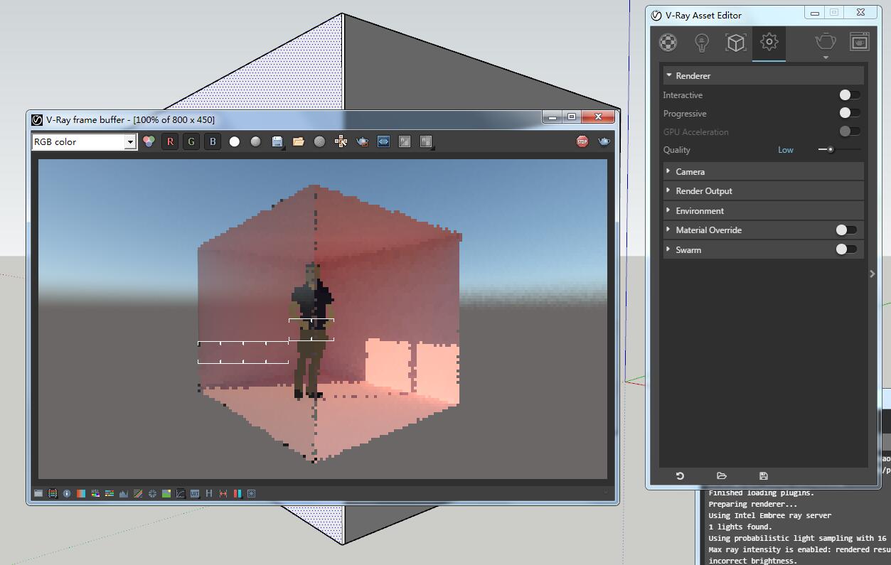

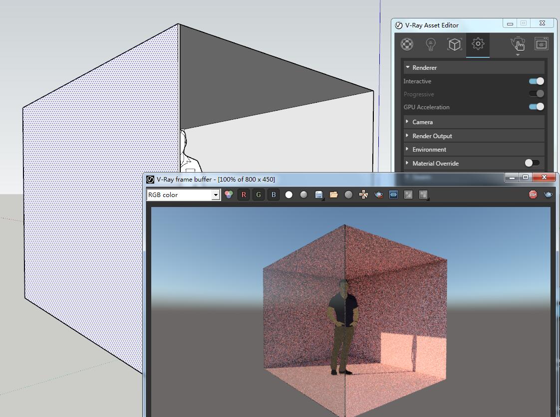

            I download and test your scene, I notice that
ID:	867035Click image for larger version
            I also found some bug(skatter grass and tree turned white in render only mode. Material from 2.0 generate black matID. etc) which I thought, developers might already have been log these as tickets.
            The only proper way to use skatter IMO is tick off the render only,then,everything will be fine
            There is a list of features that GPU could support: https://docs.chaosgroup.com/display/...tive+Rendering
            Hope these can help.
              Thank you Shiyan lin, I am not sure if this is a material issue or some rendering settings are wrong by default. I just used the Glass material from the asset Library, with no modification to the default parameters. Maybe someone can explain this and how can be fixed...
              Thank you again!
                sorry Sammyciupe
                I did not make it clear that:the face(or the face which assgined a glass material) towards your camera is not a Front Face.
                After the face flipped ,GPU and CPU produce exactly same result.
