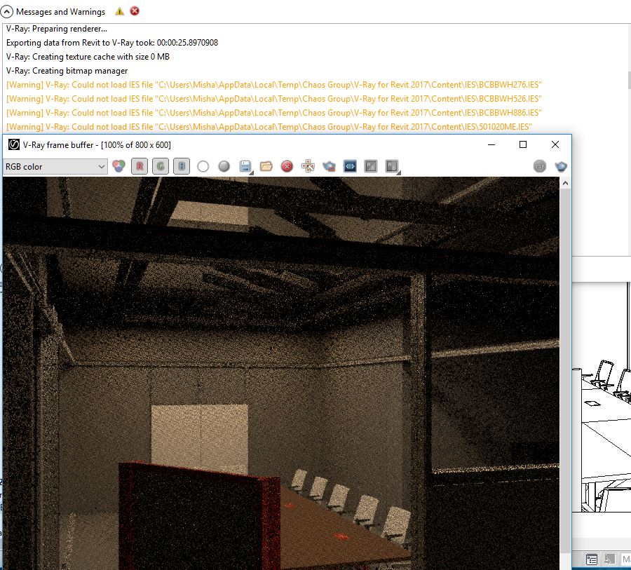

      yes there are yellow text saying " [WARNING] V-Ray: Could not load IES File C:" I checked the lights and the photometric web is in the family and the folder

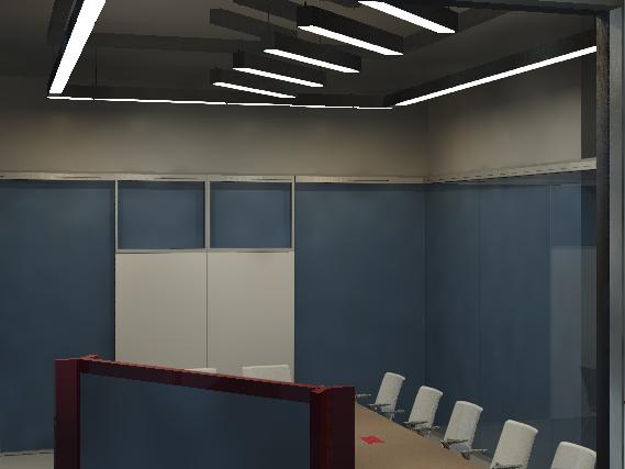

              i went ahead and changed them to generic ies files and still no luck. I did realize that some of the IES files i downloaded did not make it over to that folder. i moved the IES files into RVT2017/IES thinking that would solve it but Vray RT is still not allowing the lights to render.
              I am aware that some IES files i do not have hence the warnings, but the other lights i should have no issues with?
              I attached screen shots of both revit render and vray rt below

                We are aware of such problem which will be fixed in our next update.
                Until then can you try the workaround described in the following thread: https://forums.chaosgroup.com/showth...p-render-error
                Let me know the result.
