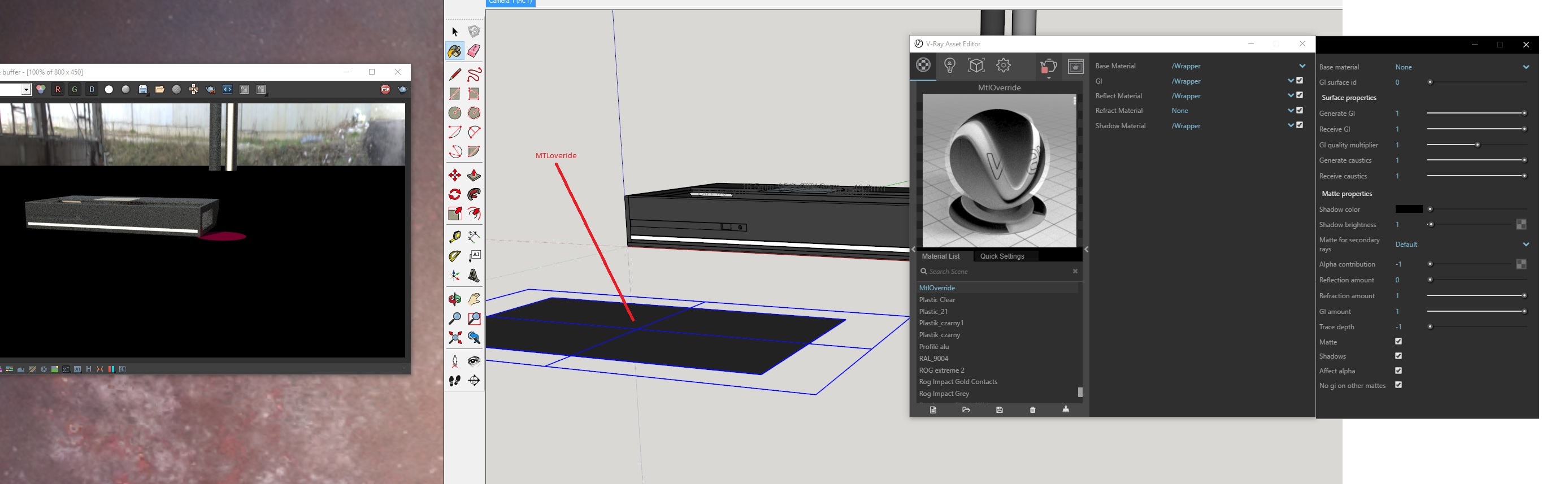

      Hello Peter,
      Thanks I try to find the right config, but it's way more complicated to me.
      Last question, I can't cast my shadow on the floor.
      The wrapper appear black....
      Do you have an idea why? (Check picture)

            Could you please send the scene to support@chaosgroup.com (accompanied with a link to this forum thread) so we can take a closer look and advise accordingly?
            Use Extensions > V-Ray > Export > Pack Project to archive it in a single file.
